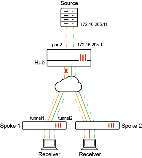

In this hub and spoke example, the PIM source is behind the hub FortiGate, and the RP is set to internal port (port2) of the hub firewall. Each spoke connects to the two WAN interfaces on the hub by using an overlay tunnel. The overlay tunnels are members of SD-WAN.
Receivers behind the spoke FortiGates request a stream from the source to receive traffic on tunnel1 by default. When the overlay tunnel goes out of SLA, the multicast traffic fails over to tunnel2 and continues to flow.
Following is an overview of how to configure the topology:
Configure the hub FortiGate in front of the PIM source. The RP is configured on internal port (port2) of the hub FortiGate.
Configure the spoke FortiGates.
Verify traffic failover.

With this configuration, multicast traffic starts on tunnel1. When tunnel1 becomes out of SLA, traffic switches to tunnel2. When tunnel1 is in SLA again, the traffic switches back to tunnel1.
