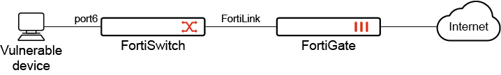

In this example, a device with a certain vulnerability severity is detected by the NAC policy on the FortiGate. Subsequently, the FortiSwitch port in which it is connected to is moved to vlan300 where traffic can be controlled for vulnerable devices. For more information about NAC policies, see Defining a FortiSwitch NAC policy in the FortiLink Administration Guide. This example assumes the vlan300 has already been configured.

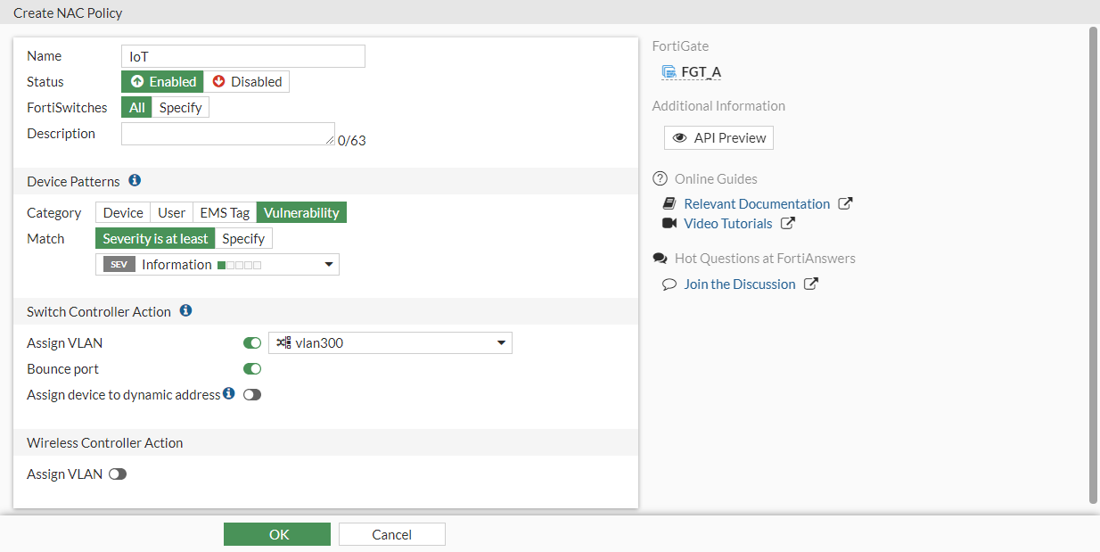

    1. Go to WiFi & Switch Controller > NAC Policies and click Create New, or edit an existing policy.
    2. In the Device Patterns section, set Category to Vulnerability.
    3. Set Match to Severity is at least and select a severity level (Information is used in this example).
    4. In the Switch Controller Action section, enable Assign VLAN and select vlan300.
    5. Configure the other settings as needed.
    6. Click OK.

  1. Configure the NAC policy:
    6. Click OK.
