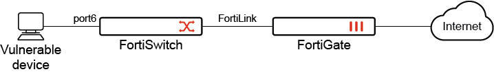

In this example, a device with a certain vulnerability severity is detected by the NAC policy on the FortiGate. Subsequently, the FortiSwitch port in which it is connected to is moved to vlan300 where traffic can be controlled for vulnerable devices. For more information about NAC policies, see Defining a FortiSwitch NAC policy in the FortiLink Administration Guide. This example assumes the vlan300 has already been configured.

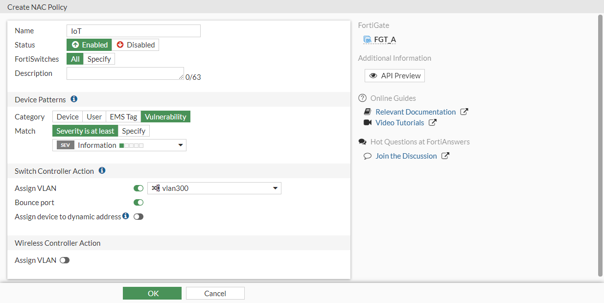

Configure the NAC policy:
Go to WiFi & Switch Controller > NAC Policies and click Create New, or edit an existing policy.
In the Device Patterns section, set Category to Vulnerability.
Set Match to Severity is at least and select a severity level (Information is used in this example).
In the Switch Controller Action section, enable Assign VLAN and select vlan300.
Configure the other settings as needed.
Click OK.

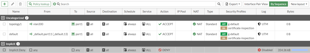

Enable application control on the firewall policy that is used to control outbound internet access for vulnerable devices (vlan300 to port1)

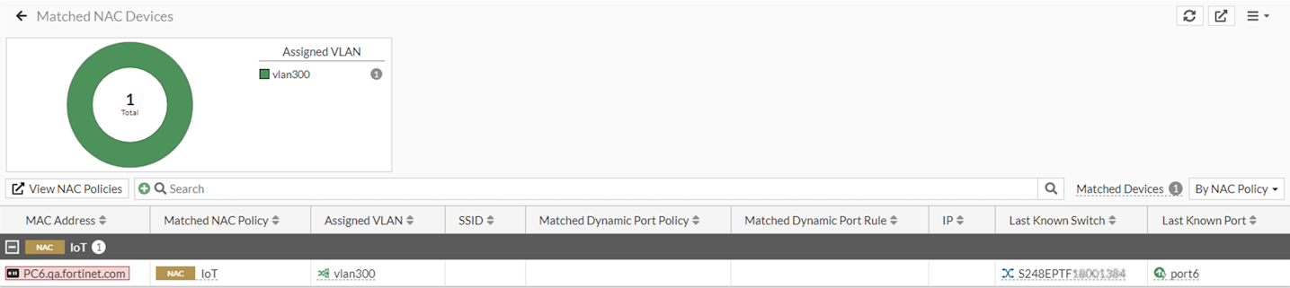

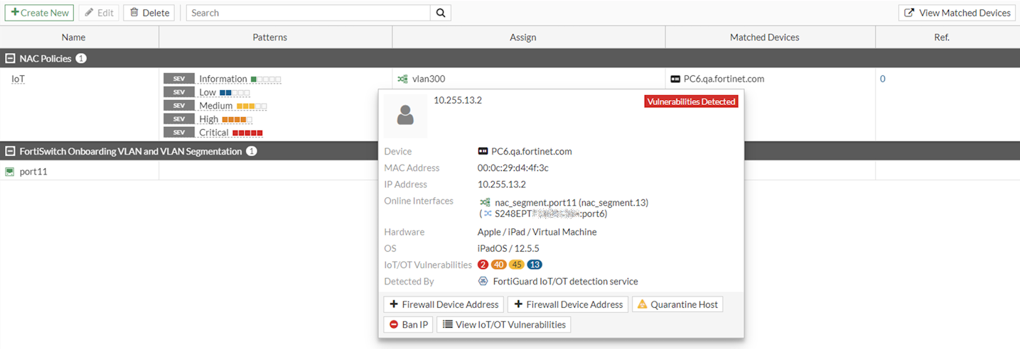

Once the NAC policy is matched, go to WiFi & Switch Controller > NAC Policies to view the device matched to the policy.
The vulnerable device is also shown on Dashboards > Assets & Identities in the Matched NAC Devices widget.

Configure a firewall policy to limit access for devices in this VLAN (vlan300).
