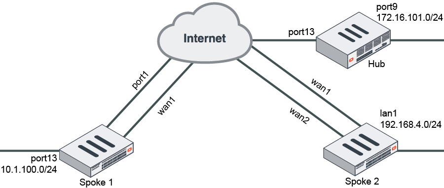

A redundant hub and spoke configuration allows VPN connections to radiate from a central FortiGate unit (the hub) to multiple remote peers (the spokes). Traffic can pass between private networks behind the hub and private networks behind the remote peers. Traffic can also pass between remote peer private networks through the hub.
This is a sample configuration of hub and spoke IPsec VPN. The following applies for this scenario:
- The spokes have two WAN interfaces and two IPsec VPN tunnels for redundancy.
- The secondary VPN tunnel is up only when the primary tunnel is down by dead peer detection.
