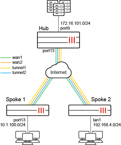

A redundant hub and spoke configuration allows VPN connections to radiate from a central FortiGate unit (the hub) to multiple remote peers (the spokes). Traffic can pass between private networks behind the hub and private networks behind the remote peers. Traffic can also pass between remote peer private networks through the hub.
This is a sample configuration of hub and spoke IPsec VPN. The following applies for this scenario:
  • The spokes have two WAN interfaces and two IPsec VPN tunnels for redundancy.
  • The secondary VPN tunnel is up only when the primary tunnel is down by dead peer detection.
Because the GUI can only complete part of the configuration, we recommend using the CLI.
To configure redundant hub and spoke VPN using the FortiOS CLI:

        set auto-negotiate enable
        set src-subnet 192.168.4.0 255.255.255.0
        edit "secondary"
        set phase1name "secondary"
        set proposal aes128-sha1 aes256-sha1 aes128-sha256 aes256-sha256 aes128gcm aes256gcm chacha20poly1305
    3. Configure the firewall policy.
      1. Configure Spoke1.
        config firewall policy
        set srcintf "dmz"
        set dstintf "primary" "secondary"
        set srcaddr "10.1.100.0"
        set dstaddr "172.16.101.0"
        set service "ALL"
      2. Configure Spoke2.
        set srcintf "lan1"
        set srcaddr "192.168.4.0"
        set service "ALL"
    4. Configure the static route.
        config router static
        edit 3
        set dst 172.16.101.0 255.255.255.0
        set distance 1
        set device "primary"
        edit 4
        set distance 3
        set device "secondary"
        edit 3
        set distance 1
        edit 4
        set distance 3
  3. Run diagnose and get commands.
    1. Run the Spoke1 # diagnose vpn tunnel list command. The system should return the following:
      name=primary ver=1 serial=1 172.16.200.1:0->172.16.202.1:0 tun_id=172.16.202.1
      bound_if=11 lgwy=static/1 tun=intf/0 mode=auto/1 encap=none/528 options[0210]=create_dev frag-rfc accept_traffic=1
      proxyid_num=1 child_num=0 refcnt=15 ilast=0 olast=0 ad=/0
      stat: rxp=1879 txp=1881 rxb=225480 txb=112860
      dpd: mode=on-demand on=1 idle=20000ms retry=3 count=0 seqno=1
      natt: mode=none draft=0 interval=0 remote_port=0
      proxyid=primary proto=0 sa=1 ref=2 serial=2 auto-negotiate
      src: 0:10.1.100.0/255.255.255.0:0 dst: 0:0.0.0.0/0.0.0.0:0 SA: ref=3 options=18227 type=00 soft=0 mtu=1438 expire=41002/0B replaywin=2048
      seqno=758 esn=0 replaywin_lastseq=00000758 itn=0
      life: type=01 bytes=0/0 timeout=42901/43200 dec: spi=0908732f esp=aes key=16 20770dfe67ea22dd8ec32c44d84ef4d5
      ah=sha1 key=20 edc89fc2ec06309ba13de95e7e486f9b795b8707
      enc: spi=a1d9eed1 esp=aes key=16 8eeea2526fba062e680d941083c8b5d1
      ah=sha1 key=20 f0f5deaf88b2a69046c3154e9f751739b3f411f5
      dec:pkts/bytes=1879/112740, enc:pkts/bytes=1879/225480
      name=secondary ver=1 serial=2 172.17.200.1:0->172.16.202.1:0 tun_id=172.16.202.1
      bound_if=5 lgwy=static/1 tun=intf/0 mode=auto/1 encap=none/528 options[0210]=create_dev frag-rfc accept_traffic=0
      proxyid_num=1 child_num=0 refcnt=10 ilast=1892 olast=1892 ad=/0
      stat: rxp=0 txp=0 rxb=0 txb=0
      dpd: mode=on-demand on=0 idle=20000ms retry=3 count=0 seqno=0
      proxyid=secondary proto=0 sa=0 ref=2 serial=2 auto-negotiate
    2. Run the Spoke1 # get router info routing-table static command. The system should return the following:
      Routing table for VRF=0
      S 172.16.101.0/24 [1/0] is directly connected, primary
