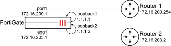

Asymmetric routing
Asymmetric routing occurs when request and response packets follow different paths that do not cross the same firewall.
In the following topology, traffic between PC1 and PC2 takes two different paths.
Traffic from PC1 to PC2 goes through the FortiGate, while traffic from PC2 to PC1 does not.
In TCP, if the packets in the request and response directions follow different paths, the FortiGate will block the packets, since the TCP three-way handshake is not established through the FortiGate.

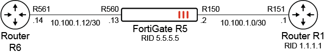

Static route tags
When a static route is configured with a route tag, it is matched in the route map, and then used to set the route's metric and advertise to the BGP neighbor. In the following example, route tag 565 is used, and router R1 receives the advertised route from the FortiGate router R5.
To configure the FortiGate:
  1. Configure the static route:
    config router static
            set dst 77.7.7.7 255.255.255.255
            set distance 2
            set device "R560"
            set tag 565
  2. Configure the route map:
    config router route-map
        edit "map1"
            config rule
                    set match-tag 565
                    set set-metric 2301
  3. Configure the BGP neighbor:
    config router bgp
        config neighbor
            edit "10.100.1.2"
                set route-map-out "map1"
    On its neighbor side, router R1 receives the advertised route from the FortiGate router R5.
  4. Verify the BGP routing table:
    # get router info routing-table bgp
    Routing table for VRF=0
    B       77.7.7.7/32 [20/2301] via 10.100.1.1 (recursive is directly connected, R150), 03:18:53, [1/0]
  5. Verify the network community:
    # get router info bgp network 77.7.7.7/32
    VRF 0 BGP routing table entry for 77.7.7.7/32
    Paths: (1 available, best #1, table Default-IP-Routing-Table)
      Advertised to non peer-group peers:
       2.2.2.2 3.3.3.3 10.100.1.5 2000::2:2:2:2
      Original VRF 0
      20
        10.100.1.1 from 10.100.1.1 (5.5.5.5)
          Origin incomplete metric 2301, localpref 200, valid, external, best
          Last update: Wed Oct  5 16:48:28 2022

Asymmetric routing
Scenario 1: PC1 starts a TCP connection with PC2
  1. The TCP SYN is allowed by the FortiGate.
  2. The TCP SYN/ACK bypasses the FortiGate.
  3. The TCP ACK is blocked by the FortiGate.
  4. Subsequent TCP packets are blocked by the FortiGate.
Scenario 2: PC2 starts a TCP connection with PC1
  1. The TCP SYN bypasses the FortiGate.
  2. The TCP SYN/ACK is blocked by the FortiGate.
  3. Subsequent TCP packets are blocked by the FortiGate.
In ICMP, consider the following scenarios.
Scenario 1: PC1 pings PC2
  1. The ICMP request passes through the FortiGate. A session is created.
  2. The ICMP reply bypasses the FortiGate, but reaches PC1. The ping is successful.
  3. The ICMP request passes through the FortiGate, and it matches the previous session.
  4. The ICMP reply bypasses the FortiGate, but it reaches PC1. The ping is successful.
  5. Subsequent ICMP requests are allowed by the FortiGate.
Scenario 2: PC2 pings PC1
  1. The ICMP request bypasses the FortiGate, but it reaches PC1.
  2. The ICMP reply passes through the FortiGate. No session is matched, and the packet is dropped.
  3. Subsequent ICMP replies are blocked by the FortiGate.
If an ICMP request does not pass through the FortiGate, but the response passes through the FortiGate, then by default it blocks the packet as invalid.
Permitting asymmetric routing
If required, the FortiGate can be configured to permit asymmetric routing.
To permit asymmetric routing:
config system settings
    set asymroute enable
This setting should be used only when the asymmetric routing issue cannot be resolved by ensuring both directions of traffic pass through the FortiGate.
When asymmetric routing is enabled and occurs, the FortiGate cannot inspect all traffic. Potentially malicious traffic may pass through and compromise the security of the network.
Asymmetric routing behaves as follows when it is permitted by the FortiGate:
TCP packets
  1. The TCP SYN is allowed by the FortiGate. The FortiGate creates a session, checks the firewall policies, and applies the configuration from the matching policy (UTM inspection, NAT, traffic shaping, and so on).
  3. The TCP ACK is allowed by the FortiGate. The packet matches the previously created session.
  4. Subsequent TCP packets are allowed by the FortiGate. The packets in the session can also be offloaded where applicable.
  2. The TCP SYN/ACK is allowed by the FortiGate. No session is matched. The packet passes to the CPU and is forwarded based on the routing table.
  3. The TCP ACK bypasses the FortiGate.
  4. Subsequent TCP packets are allowed by the FortiGate. The FortiGate acts as a router that only makes routing decisions. No security inspection is performed.
ICMP packets
  1. There is no difference from when asymmetric routing is disabled.
  2. The ICMP reply passes through the FortiGate. No session is matched. The packet passes to the CPU and is forwarded based on the routing table.
  3. Subsequent ICMP replies are allowed by the FortiGate. The FortiGate acts as a router that only makes routing decisions. No security inspection is performed.
UDP packets
Asymmetric routing does not affect UDP packets. UDP packets are checked by the session table regardless of asymmetric routing. A policy is required to allow UDP.

Static route tags
            set distance 2
            set device "R560"
            set tag 565
        edit "map1"
            config rule
                    set match-tag 565
                    set set-metric 2301
    config router bgp
        config neighbor
            edit "10.100.1.2"
      Original VRF 0
      20

    # get router info routing-table details 172.17.254.148
    Routing entry for 172.17.254.0/24
      Known via "static", distance 2, metric 0, best
      * vrf 0 172.16.200.254, via port1, prefsrc 1.1.1.1
      * vrf 0 172.16.203.2, via agg1, prefsrc 1.1.1.2
  3. Run a sniffer trace after some traffic passes:
    # diagnose sniffer packet any "host 172.17.254.148" 4
    interfaces=[any]
    filters=[host 172.17.254.148]
    1.319811 port1 out 1.1.1.1.1371 -> 172.17.254.148.53: udp 43
    1.320095 port1 in 172.17.254.148.53 -> 1.1.1.1.1371: udp 310
    1.921718 port1 out 1.1.1.1.1371 -> 172.17.254.148.53: udp 27
    2.031520 port1 in 172.17.254.148.53 -> 1.1.1.1.1371: udp 213
    When DNS traffic leaves the FortiGate and is routed through port1, the source address 1.1.1.1 is used.
