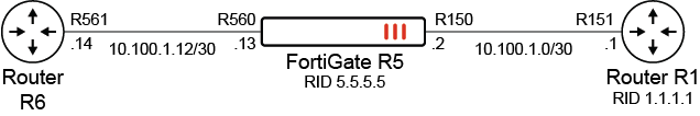

Static route tags
When a static route is configured with a route tag, it is matched in the route map, and then used to set the route's metric and advertise to the BGP neighbor. In the following example, route tag 565 is used, and router R1 receives the advertised route from the FortiGate router R5.
To configure the FortiGate:
Configure the static route:
config router static edit 1 set dst 77.7.7.7 255.255.255.255 set distance 2 set device "R560" set tag 565 next end -
Configure the route map:
config router route-map edit "map1" config rule edit 2 set match-tag 565 set set-metric 2301 next end next end -
Configure the BGP neighbor:
config router bgp config neighbor edit "10.100.1.2" set route-map-out "map1" next end endOn its neighbor side, router R1 receives the advertised route from the FortiGate router R5.
Verify the BGP routing table:
# get router info routing-table bgp Routing table for VRF=0 B 77.7.7.7/32 [20/2301] via 10.100.1.1 (recursive is directly connected, R150), 03:18:53, [1/0]
Verify the network community:
# get router info bgp network 77.7.7.7/32 VRF 0 BGP routing table entry for 77.7.7.7/32 Paths: (1 available, best #1, table Default-IP-Routing-Table) Advertised to non peer-group peers: 2.2.2.2 3.3.3.3 10.100.1.5 2000::2:2:2:2 Original VRF 0 20 10.100.1.1 from 10.100.1.1 (5.5.5.5) Origin incomplete metric 2301, localpref 200, valid, external, best Last update: Wed Oct 5 16:48:28 2022

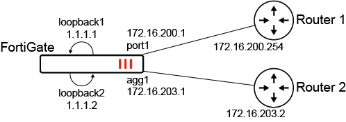

Defining a preferred source IP for local-out egress interfaces
The preferred source IP can be configured on a static route so that local-out traffic is sourced from that IP. In the following example, a source IP is defined per static route. Local traffic that uses the static route will use the source IP instead of the interface IP associated with the route.
To configure preferred source IPs for static routes:
Configure the static routes:
config router static edit 22 set dst 172.17.254.0 255.255.255.0 set gateway 172.16.200.254 set preferred-source 1.1.1.1 set distance 2 set device "port1" next edit 23 set dst 172.17.254.0 255.255.255.0 set gateway 172.16.203.2 set preferred-source 1.1.1.2 set distance 2 set device "agg1" next end -
Configure the primary DNS server IP address:
config system dns set primary 172.17.254.148 end
To verify the configuration:
Verify the kernel routing table:
# get router info kernel ... tab=254 vf=0 scope=0 type=1 proto=11 prio=1 0.0.0.0/0.0.0.0/0->172.17.254.0/24 pref=0.0.0.0 gwy=172.16.200.254 flag=14 hops=0 oif=9(port1) pref=1.1.1.1 gwy=172.16.203.2 flag=14 hops=0 oif=33(agg1) pref=1.1.1.2 -
Verify the routing table for 172.17.254.148:
# get router info routing-table details 172.17.254.148 Routing table for VRF=0 Routing entry for 172.17.254.0/24 Known via "static", distance 2, metric 0, best * vrf 0 172.16.200.254, via port1, prefsrc 1.1.1.1 * vrf 0 172.16.203.2, via agg1, prefsrc 1.1.1.2
Run a sniffer trace after some traffic passes:
# diagnose sniffer packet any "host 172.17.254.148" 4 interfaces=[any] filters=[host 172.17.254.148] 1.319811 port1 out 1.1.1.1.1371 -> 172.17.254.148.53: udp 43 1.320095 port1 in 172.17.254.148.53 -> 1.1.1.1.1371: udp 310 1.921718 port1 out 1.1.1.1.1371 -> 172.17.254.148.53: udp 27 2.031520 port1 in 172.17.254.148.53 -> 1.1.1.1.1371: udp 213
When DNS traffic leaves the FortiGate and is routed through port1, the source address 1.1.1.1 is used.
