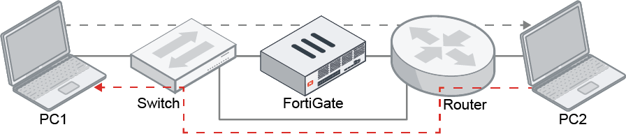

Asymmetric routing
Asymmetric routing occurs when request and response packets follow different paths that do not cross the same firewall.
In the following topology, traffic between PC1 and PC2 takes two different paths.
Traffic from PC1 to PC2 goes through the FortiGate, while traffic from PC2 to PC1 does not.
In TCP, if the packets in the request and response directions follow different paths, the FortiGate will block the packets, since the TCP three-way handshake is not established through the FortiGate.

Asymmetric routing
Scenario 1: PC1 starts a TCP connection with PC2
  1. The TCP SYN is allowed by the FortiGate.
  2. The TCP SYN/ACK bypasses the FortiGate.
  3. The TCP ACK is blocked by the FortiGate.
  4. Subsequent TCP packets are blocked by the FortiGate.
Scenario 2: PC2 starts a TCP connection with PC1
  1. The TCP SYN bypasses the FortiGate.
  2. The TCP SYN/ACK is blocked by the FortiGate.
  3. Subsequent TCP packets are blocked by the FortiGate.
In ICMP, consider the following scenarios.
Scenario 1: PC1 pings PC2
  1. The ICMP request passes through the FortiGate. A session is created.
  2. The ICMP reply bypasses the FortiGate, but reaches PC1. The ping is successful.
  3. The ICMP request passes through the FortiGate, and it matches the previous session.
  4. The ICMP reply bypasses the FortiGate, but it reaches PC1. The ping is successful.
  5. Subsequent ICMP requests are allowed by the FortiGate.
Scenario 2: PC2 pings PC1
  1. The ICMP request bypasses the FortiGate, but it reaches PC1.
  2. The ICMP reply passes through the FortiGate. No session is matched, and the packet is dropped.
  3. Subsequent ICMP replies are blocked by the FortiGate.
