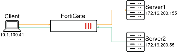

In this example, a NAT44 FPR IP pool with permit-any-host enabled is created and applied to a policy. The packet is sent from Client1 to Server1 that hits the policy. The session list is checked for the NAT IP address and port, 172.16.201.3 and 1033. The expectation session list is checked to see that the session will be used to allow access to the NAT IP address and port from any other external host, such as Server2. The packet sent from Server2 to the NAT IP address and port is forwarded to Client1.

  5. Check that the packet sent from Server2 to the NAT IP address and port number is forwarded to Client1:
    # diagnose sniffer packet any 'udp and port 1033 or 20041' 4
    interfaces=[any]
    filters=[udp and port 1033 or 20041]
    12.001145 port1 in 172.16.200.55.4155 -> 172.16.201.3.1033: udp 4
    12.001180 port2 out 172.16.200.55.4155 -> 10.1.100.41.20041: udp 4
    2 packets received by filter
    0 packets dropped by kernel
