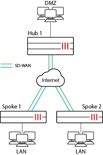

The packet duplication feature works best in a spoke-spoke or hub-and-spoke topology. In this example, a hub-and-spoke ADVPN topology is used. Before shortcuts are established, Hub 1 forwards the duplicate packets from Spoke 1 to Spoke 2. Once shortcuts are established, Hub 1 is transparent, and duplicate packets are exchanged directly between the spokes.
To configure packet duplication between Spoke 1 and Spoke 2:
