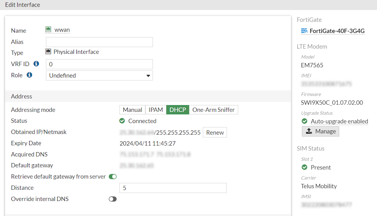

Go to Network > Interfaces.
Select the LTE modem interface and click Edit.
Click Manage.

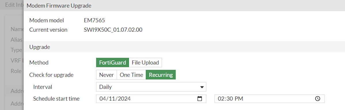

Set the Method as FortiGuard.
Configure the upgrade schedule:
Never: Disable LTE modem firmware upgrades from FortiGuard.

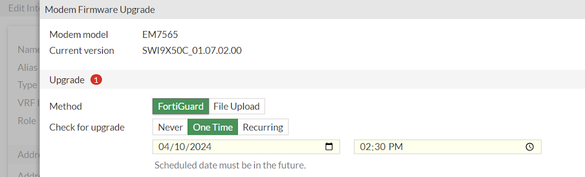

One Time: Schedule a date and time to upgrade the firmware from FortiGuard.
Recurring: Schedule a recurring upgrade to the firmware from FortiGuard based on a set Interval, start date, and start time.
