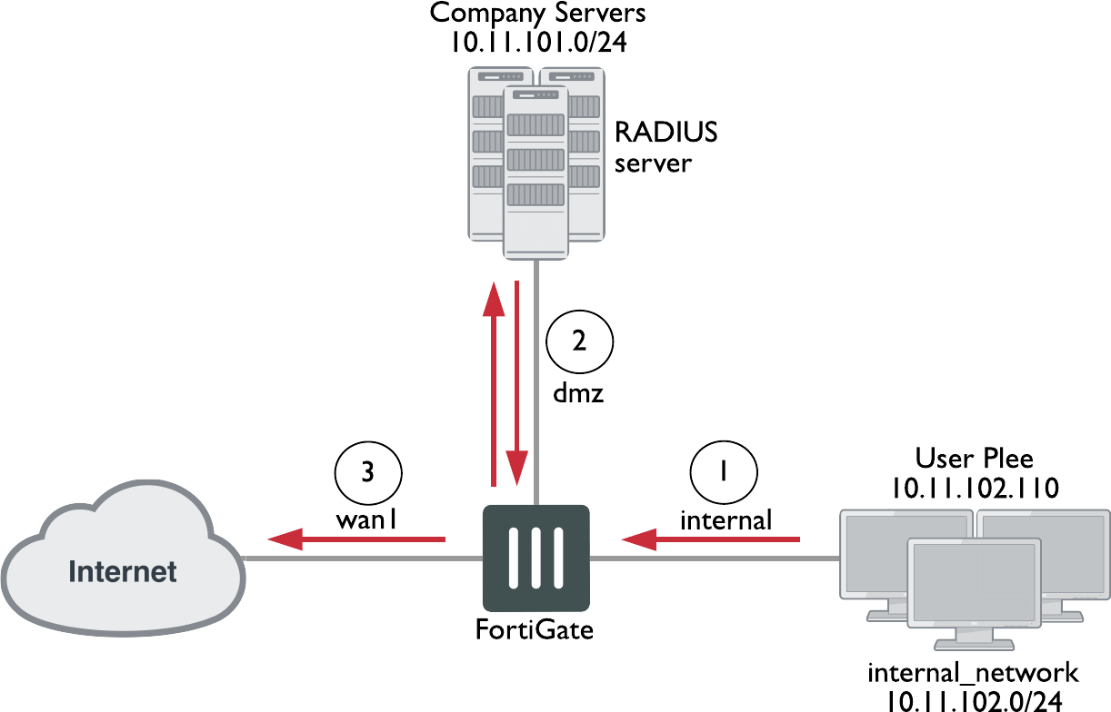

A common RADIUS SSO (RSSO) topology involves a medium-sized company network of users connecting to the Internet through the FortiGate and authenticating with a RADIUS server. The following describes how to configure FortiOS for this scenario. The example makes the following assumptions:
- VDOMs are not enabled.
- The super_admin account is used for all FortiGate configuration.
- A RADIUS server is installed on a server or FortiAuthenticator and uses default attributes.
- BGP is used for any dynamic routing.
- You have configured authentication event logging under Log & Report.
Example.com has an office with 20 users on the internal network who need access to the Internet. The office network is protected by a FortiGate-60C with access to the Internet through the wan1 interface, the user network on the internal interface, and all servers are on the DMZ interface. This includes an Ubuntu sever running FreeRADIUS. This example configures two users:

You must define a DHCP server for the internal network, as this network type typically uses DHCP. The wan1 and dmz interfaces are assigned static IP addresses and do not need a DHCP server. The following table shows the FortiGate interfaces used in this example:
| Interface | Subnet | Act as DHCP server | Devices |
| wan1 | 172.20.120.141 | No | Internet service provider |
| dmz | 10.11.101.100 | No | Servers including RADIUS server |
| internal | 10.11.102.100 | Yes: x.x.x.110-250 | Internal user network |

To test the configuration:
Once configured, a user only needs to log in to their PC using their RADIUS account. After that, when they attempt to access the Internet, the FortiGate uses their session information to get their RADIUS information. Once the user is verified, they can access the website.
- The user logs on to their PC and tries to access the Internet.
- The FortiGate contacts the RADIUS server for the user's information. Once confirmed, the user can access the Internet. Each step generates logs that enable you to verify that each step succeeded.
- If a step does not succeed, confirm that your configuration is correct.
