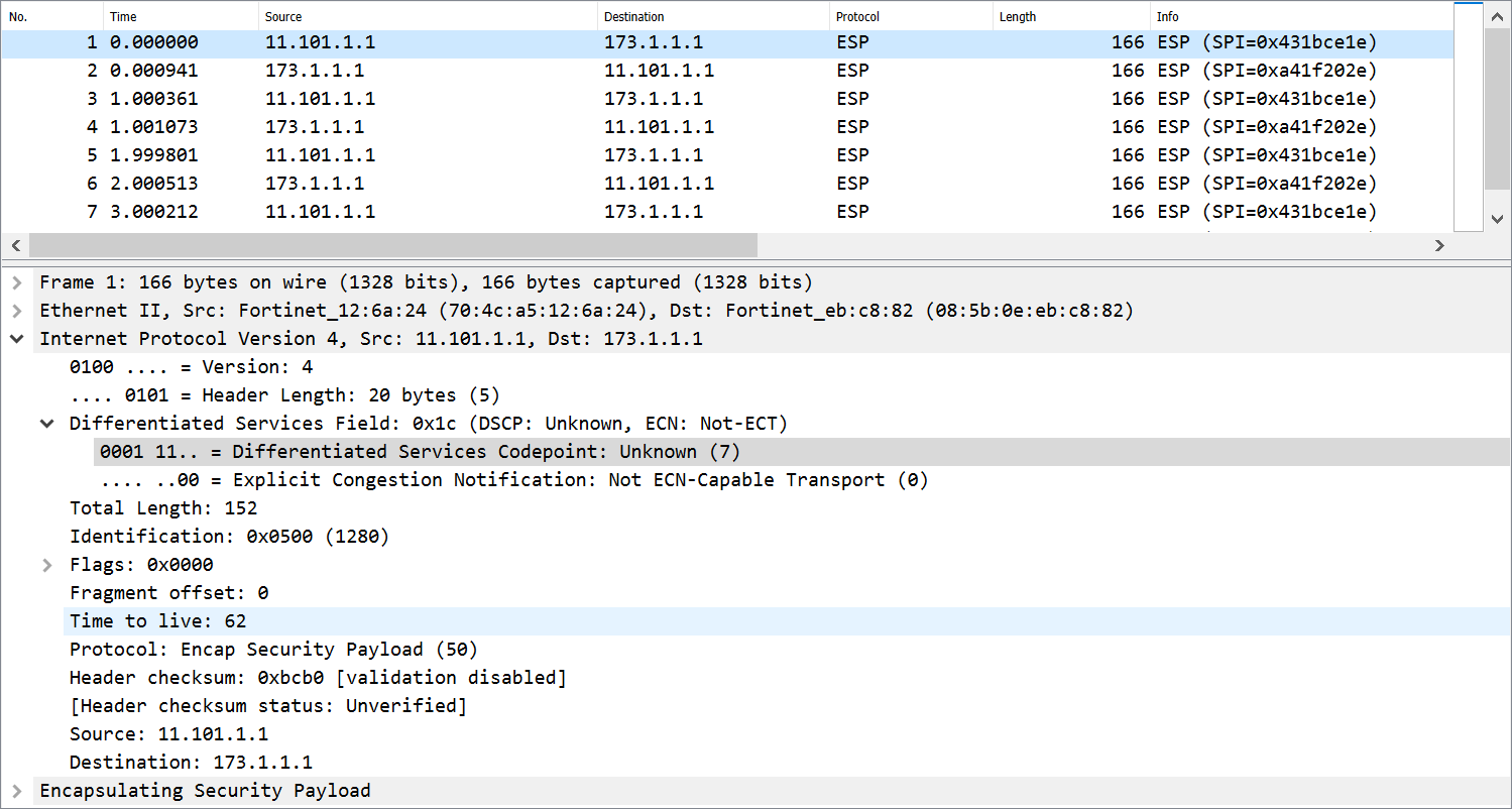

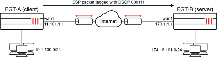

In this example, NPU offloading is disabled, diffserv is enabled, and the diffserv code is set to 000111 on FGT-A. ESP packets egressing from FGT-A will have the DSCP tag which can be used by the ISP for QoS purpose. Only one side of the tunnel needs to have diffserv enabled.

  4. Use a packet analyzer, or sniffer, to check the ESP packets:
