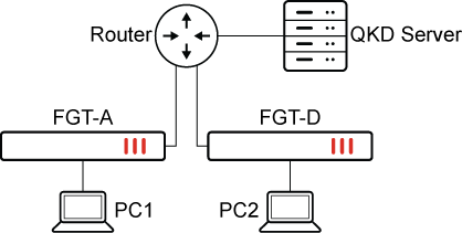

In such a scenario, the financial institution could enable QKD for advanced quantum security, PQC for resilience against quantum threats, and DH for traditional key exchange. By combining these methods, they can tailor their security approach to meet specific needs and maximize resilience against potential threats.
Example
To configure IPsec key retrieval with a QKD and PQC keys together by CLI:

To verify the configuration on FGT-A:
  1. Generate traffic between PC1 and PC4.

          edit "test_qkd"
              set interface "test_qkd"
              set peertype any
              set net-device disable
              set proposal aes128-sha256 aes256-sha256 aes128gcm-prfsha256 aes256gcm-prfsha384 chacha20poly1305-prfsha256
              set dhgrp 21
              set addke1 1080
              set qkd require
              set qkd-hybrid require
              set qkd-profile "qkdtest"
              set remote-gw 11.101.1.1
              set psksecret **********
    3. Configure the IPsec phase2 interface :
          edit "test_qkd"
              set phase1name "test_qkd"
              set proposal aes128-sha1 aes256-sha1 aes128-sha256 aes256-sha256 aes128gcm aes256gcm chacha20poly1305
              set dhgrp 20 21
              set addke1 35
