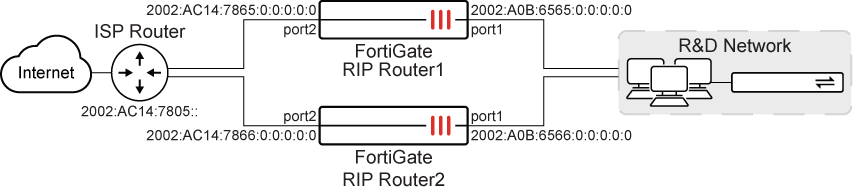

In this example, a small network is configured with RIP next generation (RIPng). Two FortiGates are connected to the internal network and the ISP, providing some redundancy to help ensure that the internal network can always reach the internet.
The FortiGates are running in NAT mode with VDOMs disabled, and firewall policies have already been configured to allow traffic to flow across the interfaces.
All of the internal computers and other network devices support IPv6 addressing and are running RIPng (where applicable), so no static routing is required. Internal network devices only need to know the FortiGate's internal interface network addresses.
