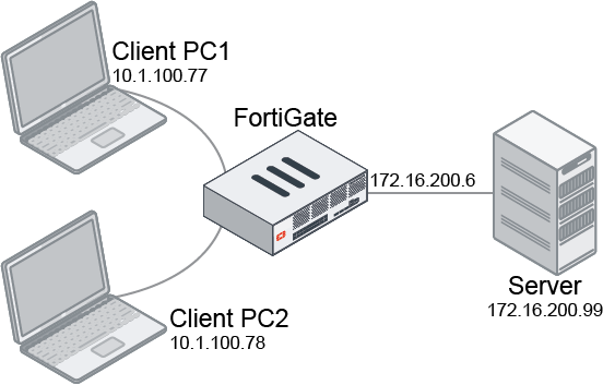

In this example, multiple clients submit requests in HTTP2. The requests hit the VIP address, and then FortiGate opens a session between itself (172.16.200.6) and the server (172.16.200.99). The coalescing occurs in this session as the multiple streams share the same TLS session to connect to the same destination server.

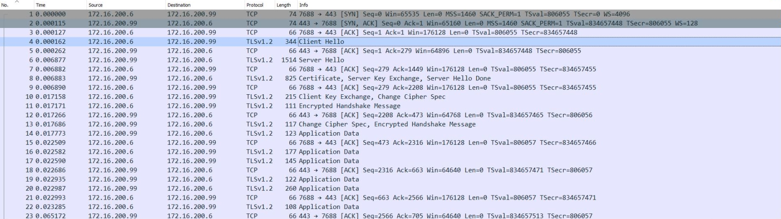

Get the clients to access the VIP address (10.1.100.222). The FortiGate shares the first TLS connection with second TLS connection.
Verify the sniffer packet capture on the FortiGate server side. There is one client hello.

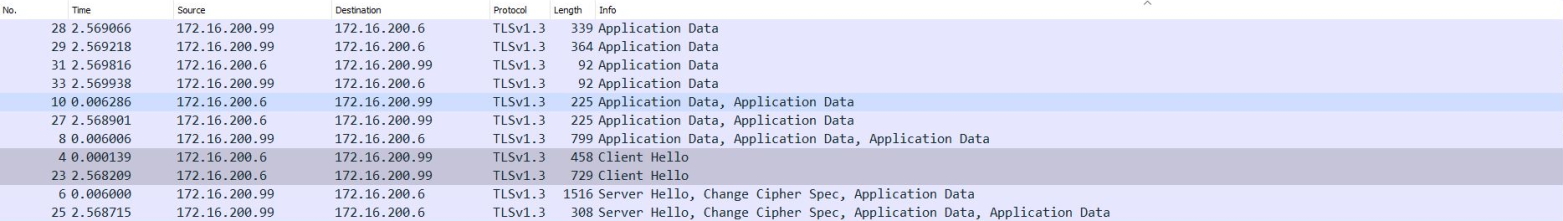

Disable HTTP multiplexing:
config firewall vip edit "vip-test" config realservers edit 1 set type ip set ip 172.16.200.99 set port 443 next end set http-multiplex disable next end -
Verify the sniffer packet capture. This time, the FortiGate does reuse the TLS connection, so there are two client hellos sent to the real server.
