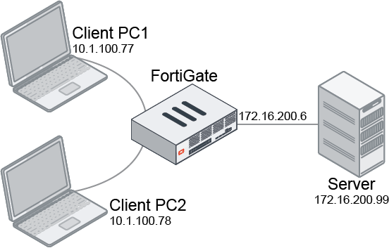

In this example, multiple clients submit requests in HTTP2. The requests hit the VIP address, and then FortiGate opens a session between itself (172.16.200.6) and the server (172.16.200.99). The coalescing occurs in this session as the multiple streams share the same TLS session to connect to the same destination server.

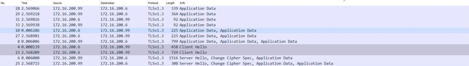

Verify the sniffer packet capture on the FortiGate server side. There is one client hello.

Verify the sniffer packet capture. This time, the FortiGate does reuse the TLS connection, so there are two client hellos sent to the real server.
