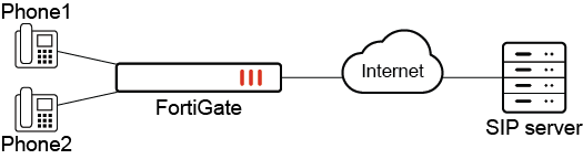

Example
In this example, SIP ALG is required for pinhole creation, handling NAT, and controlling SIP messages that requires flow-based SIP. The administrator needs to configure two SIP profiles, one with each feature set (voipd and ips), and apply these SIP profiles in the same firewall policy.
