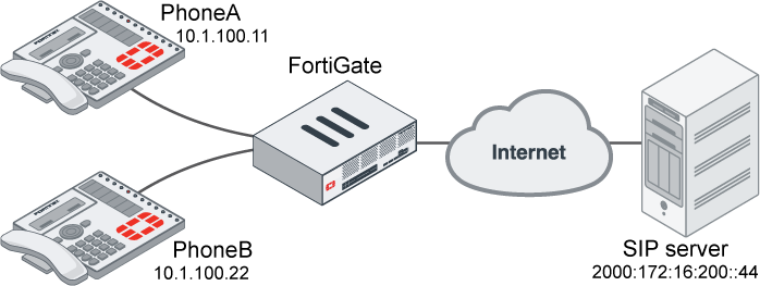

NAT46 example
In this example, SIP phones on the internal network use IPv4, and the SIP server on an external network uses IPv6. NAT46 is used with SIP ALG to allow for seamless communication. A VoIP profile, sip, has already been created.
To configure the FortiGate:
Configure a firewall VIP with NAT46 enabled:
config firewall vip edit "vip46_server_asterisk" set extip 10.1.100.100 set nat44 disable set nat46 enable set extintf "port1" set ipv6-mappedip 2000:172:16:200::44 next end -
Configure an IPv6 pool:
config firewall ippool6 edit "client_server_nat46" set startip 2000:172:16:200::200 set endip 2000:172:16:200::207 set nat46 enable next end -
Configure a firewall policy:
config firewall policy edit 1 set name "policy46-1" set srcintf "port1" set dstintf "port9" set action accept set nat46 enable set srcaddr "all" set dstaddr "vip46_server_asterisk" set srcaddr6 "all" set dstaddr6 "all" set schedule "always" set service "ALL" set utm-status enable set inspection-mode proxy set voip-profile "sip" set logtraffic all set auto-asic-offload disable set ippool enable set poolname6 "client_server_nat46" next end
