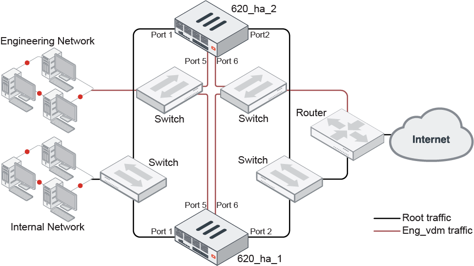

This example shows a virtual cluster configuration consisting of two FortiGates. The virtual cluster has two VDOMs, Root and End_vdm.
The root VDOM can only be associated with virtual cluster 1. The VDOM that is assigned as the management VDOM can also only be associated with virtual cluster 1. |

- Make all the necessary connections as shown in the topology diagram.

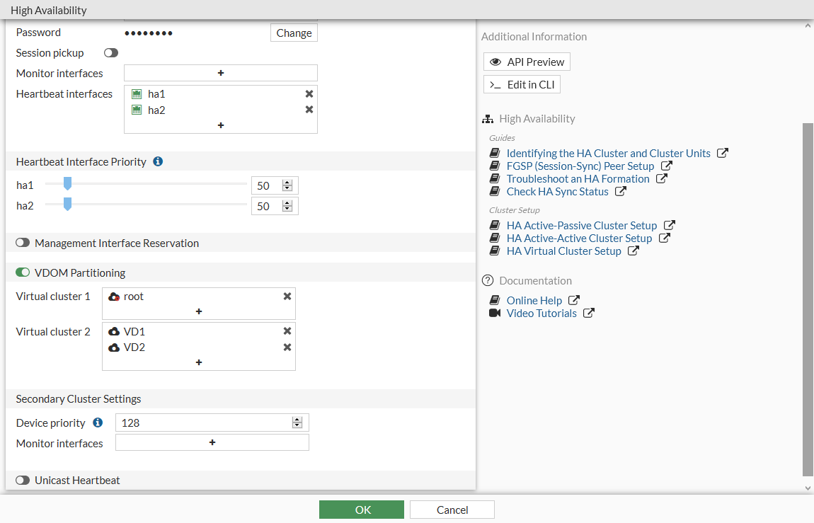

- Implement a virtual cluster by moving the new VDOMs to Virtual cluster 2:
- Go to System > HA.
- Enable VDOM Partitioning.
- Click on the Virtual cluster 2 field and select the new VDOMs.
- Click OK.
