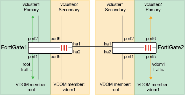

In an active-passive virtual cluster of two FortiGates, the first and second FortiGates share traffic processing according to the VDOM partitioning configuration. The following is an example of two virtual clusters, with each member acting as primary for different vclusters.

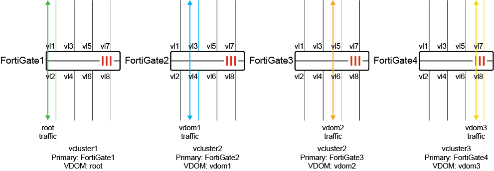

For better load balancing, it is recommended to have as many vclusters as there are HA members. This way, each HA member can be a primary unit for each cluster, thereby processing traffic while standing by for the other vcluster as secondary. The following is an example of four FortiGates in an FGCP cluster, with four vclusters and four VDOMs. Each FortiGate is the primary unit for a vcluster and actively processes traffic as the primary member.

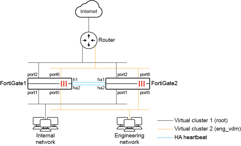

This example shows a virtual cluster configuration consisting of two FortiGates. The virtual cluster has two VDOMs, root and eng_vdm.

Make all the necessary connections as shown in the topology diagram.
