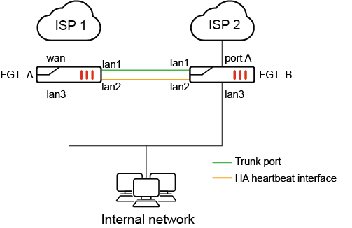

In this SD-WAN configuration, two FortiGates in an active-passive (A-P) HA pair are used to provide hardware redundancy. Instead of using external switches to provide a mesh network connection to the ISP routers, each FortiGate connects to an ISP and uses a virtual VLAN switch to connect to each other. Virtual VLAN switch mode allows 802.1Q VLANs to be assigned to it, and the configuration of one interface as a trunk port.
Only FortiGate models that support the virtual VLAN switch feature can be used for this solution. See Virtual VLAN switch for details. |
In this topology:
An HA cluster of two FortiGate 40Fs is used as an example
The lan interface is broken up into lan1, lan2 and lan3
lan1 is connected between FGT_A and FGT_B and designated as a virtual VLAN switch trunk port
lan2 is used for HA heartbeat, connecting the two FortiGates in HA
lan3 is connected to the internal network
wan is connected to ISP1 on FGT_A
port A is connected to ISP on FGT_B
Two VLANs are created (VLAN 10 and VLAN 20), and assigned to two VLAN switches. Each VLAN switch has the WAN interfaces (wan and port A) as its member.
When FGT_A is the primary device, it reaches ISP1 directly via the local wan interface and reaches ISP2 via the trunk port towards FGT_B. Packets are tagged/untagged as VLAN 10 as it passes through the trunk before egressing on port A on FGT_B.
When FGT_B is the primary device, it reaches ISP2 directly via the local port A interface and reaches ISP1 via the trunk port towards FGT_A. Packets are tagged/untagged as VLAN 20 as it passes through the trunk before egressing on the wan interface on FGT_A.
