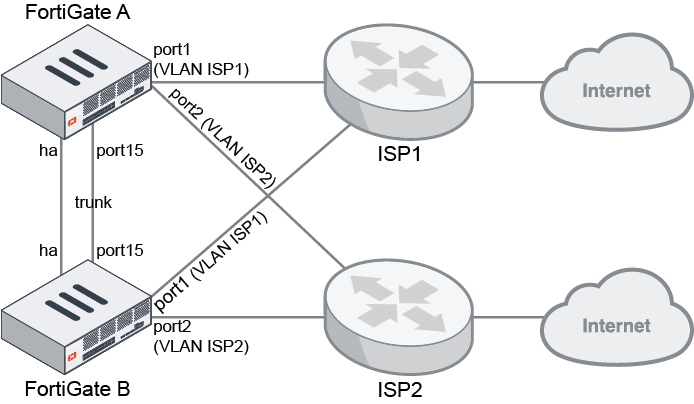

Example 1: HA using a VLAN switch
In this example, two FortiGates in an HA cluster are connected to two ISP routers. Instead of connecting to external L2 switches, each FortiGate connects to each ISP router on the same hardware switch port on the same VLAN. A trunk port connects the two FortiGates to deliver the 802.1Q tagged traffic to the other. A full mesh between the FortiGate cluster and the ISP routers is achieved where no single point of failure will cause traffic disruptions.
This example assumes that the HA settings are already configured. The interface and VLAN switch settings are identical between cluster members and synchronized. See HA using a hardware switch to replace a physical switch for a similar example that does not use a VLAN switch.
To configure the VLAN switches:
  1. Configure the ISP interfaces with the corresponding VLAN IDs:
    config system virtual-switch
        edit "ISP1"
            set physical-switch "sw0"
            set vlan 2951
            config port
                edit "port1"
        edit "ISP2"
            set vlan 2952
            config port
                edit "port2"
  2. Configure the VLAN switch interface addressing:
    config system interface
        edit "ISP1"
            set vdom "root"
            set ip 192.168.10.99 255.255.255.0
            set allowaccess ping
            set type hard-switch
        edit "ISP2"
            set vdom "root"
            set ip 192.168.20.99 255.255.255.0
  3. Designate port15 as the trunk port:
        edit port15
            set trunk enable
  4. Configure firewall policies to allow outgoing traffic on the ISP1 and ISP2 interfaces:
    config firewall policy
            set srcintf "port11"
            set dstintf "ISP1"
            set srcaddr "all"
            set dstaddr "all"
            set service "ALL"
            set nat enable
            set dstintf "ISP2"
            set srcaddr "all"
            set dstaddr "all"
            set service "ALL"
            set nat enable

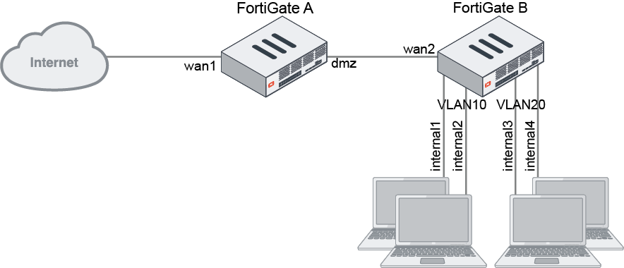

Example 2: LAN extension
In this example, two hardware switch ports are assigned VLAN10, and two ports are assigned VLAN20 on FortiGate B. The wan2 interface is designated as the trunk port, and is connected to the upstream FortiGate A. The corresponding VLAN subinterfaces VLAN10 and VLAN20 on the upstream FortiGate allow further access to other networks.
The available interfaces and VLAN IDs varies between FortiGate models. The FortiGate B in this example is a 60F model.
To configure FortiGate B:
  1. Configure the VLAN interfaces:
        edit "VLAN10"
            set vlan 10
            config port
                edit "internal1"
                edit "internal2"
        edit "VLAN20"
            set vlan 20
            config port
                edit "internal3"
                edit "internal4"
        edit "VLAN10"
            set vdom "root"
            set allowaccess ping https ssh snmp http fgfm
        edit "VLAN20"
            set vdom "root"
  3. Designate wan2 as the trunk port:
        edit wan2
            set trunk enable
To configure FortiGate A:
  1. Configure the VLAN subinterfaces:
        edit "VLAN10"
            set ip 192.168.10.98 255.255.255.0
            set role lan
            set interface "dmz"
            set vlanid 10
        edit "VLAN20"
            set ip 192.168.20.98 255.255.255.0
            set role lan
            set interface "dmz"
            set vlanid 20
  2. Configure the DHCP server on VLAN10:
    config system dhcp server
        edit 0
            set dns-service default
            set default-gateway 192.168.10.98
            set netmask 255.255.255.0
            set interface "VLAN10 "
            config ip-range
                    set start-ip 192.168.10.100
                    set end-ip 192.168.10.254
            set timezone-option default
  3. Configure firewall policies that allow traffic from the VLAN10 and VLAN20 interfaces to the internet:
        edit 0
            set name "VLAN10-out"
            set srcintf "VLAN10"
            set dstintf "wan1"
            set srcaddr "all"
            set dstaddr "all"
            set service "ALL"
            set nat enable
        edit 0
            set name "VLAN20-out"
            set srcintf "VLAN20"
            set dstintf "wan1"
            set srcaddr "all"
            set dstaddr "all"
            set service "ALL"
            set nat enable
To test the connection:
  1. Connect a PC to internal1 on FortiGate B.
  2. Verify that it receives an IP address from FortiGate A’s DHCP server.
  3. From the PC, ping FortiGate B on 192.168.10.99.
  4. Ping FortiGate A on 192.168.10.98.
  5. Connect to the internet. Traffic is allowed by the VLAN10-out policy.
