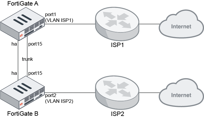

Example 1: HA using a VLAN switch
In this example, two FortiGates in an HA cluster are connected to two ISP routers. Instead of connecting to external L2 switches, each FortiGate connects to each ISP router on the same hardware switch port on the same VLAN. A trunk port connects the two FortiGates to deliver the 802.1Q tagged traffic to the other. A full mesh between the FortiGate cluster and the ISP routers is achieved where no single point of failure will cause traffic disruptions.
This example assumes that the HA settings are already configured. The interface and VLAN switch settings are identical between cluster members and synchronized. See HA using a hardware switch to replace a physical switch for a similar example that does not use a VLAN switch.
To configure the VLAN switches:
Configure the ISP interfaces with the corresponding VLAN IDs:
config system virtual-switch edit "ISP1" set physical-switch "sw0" set vlan 2951 config port edit "port1" next end next edit "ISP2" set physical-switch "sw0" set vlan 2952 config port edit "port2" next end next end -
Configure the VLAN switch interface addressing:
config system interface edit "ISP1" set vdom "root" set ip 192.168.10.99 255.255.255.0 set allowaccess ping set type hard-switch next edit "ISP2" set vdom "root" set ip 192.168.20.99 255.255.255.0 set allowaccess ping set type hard-switch next end -
Designate port15 as the trunk port:
config system interface edit port15 set trunk enable next end -
Configure firewall policies to allow outgoing traffic on the ISP1 and ISP2 interfaces:
config firewall policy edit 1 set srcintf "port11" set dstintf "ISP1" set srcaddr "all" set dstaddr "all" set action accept set schedule "always" set service "ALL" set nat enable next edit 2 set srcintf "port11" set dstintf "ISP2" set srcaddr "all" set dstaddr "all" set action accept set schedule "always" set service "ALL" set nat enable next end

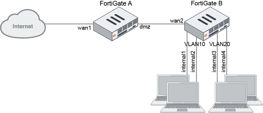

Example 2: LAN extension
In this example, two hardware switch ports are assigned VLAN10, and two ports are assigned VLAN20 on FortiGate B. The wan2 interface is designated as the trunk port, and is connected to the upstream FortiGate A. The corresponding VLAN subinterfaces VLAN10 and VLAN20 on the upstream FortiGate allow further access to other networks.
The available interfaces and VLAN IDs varies between FortiGate models. The FortiGate B in this example is a 60F model. |
To configure FortiGate B:
Configure the VLAN interfaces:
config system virtual-switch edit "VLAN10" set physical-switch "sw0" set vlan 10 config port edit "internal1" next edit "internal2" next end next edit "VLAN20" set physical-switch "sw0" set vlan 20 config port edit "internal3" next edit "internal4" next end next end -
config system interface edit "VLAN10" set vdom "root" set ip 192.168.10.99 255.255.255.0 set allowaccess ping https ssh snmp http fgfm set type hard-switch next edit "VLAN20" set vdom "root" set ip 192.168.20.99 255.255.255.0 set allowaccess ping https ssh snmp http fgfm set type hard-switch next end -
Designate wan2 as the trunk port:
config system interface edit wan2 set trunk enable next end
To configure FortiGate A:
Configure the VLAN subinterfaces:
config system interface edit "VLAN10" set ip 192.168.10.98 255.255.255.0 set allowaccess ping https ssh set role lan set interface "dmz" set vlanid 10 next edit "VLAN20" set ip 192.168.20.98 255.255.255.0 set allowaccess ping https ssh set role lan set interface "dmz" set vlanid 20 next end -
Configure the DHCP server on VLAN10:
config system dhcp server edit 0 set dns-service default set default-gateway 192.168.10.98 set netmask 255.255.255.0 set interface "VLAN10 " config ip-range edit 1 set start-ip 192.168.10.100 set end-ip 192.168.10.254 next end set timezone-option default next end -
Configure firewall policies that allow traffic from the VLAN10 and VLAN20 interfaces to the internet:
config firewall policy edit 0 set name "VLAN10-out" set srcintf "VLAN10" set dstintf "wan1" set srcaddr "all" set dstaddr "all" set action accept set schedule "always" set service "ALL" set nat enable next edit 0 set name "VLAN20-out" set srcintf "VLAN20" set dstintf "wan1" set srcaddr "all" set dstaddr "all" set action accept set schedule "always" set service "ALL" set nat enable next end
To test the connection:
Connect a PC to internal1 on FortiGate B.
Verify that it receives an IP address from FortiGate A’s DHCP server.
From the PC, ping FortiGate B on 192.168.10.99.
Ping FortiGate A on 192.168.10.98.
Connect to the internet. Traffic is allowed by the VLAN10-out policy.
