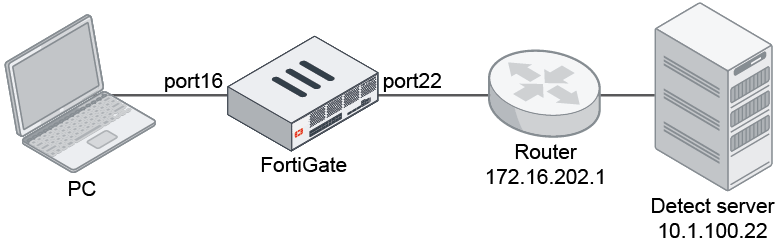

In the following topology, the FortiGate is monitoring the detect server, 10.1.100.22. The FortiGate has a policy-based route to destination 172.16.205.10 using the same gateway (172.16.202.1) and interface (port22). By configuring update-policy-route disable, the policy-based route is not removed when the link health monitor detects a failure.

- Configure the link health monitor:
config system link-monitor edit "test-1" set srcintf "port22" set server "10.1.100.22" set gateway-ip 172.16.202.1 set failtime 3 set update-policy-route disable next end - Configure the policy route:
config router policy edit 1 set input-device "port16" set dst "172.16.205.10/255.255.255.255" set gateway 172.16.202.1 set output-device "port22" set tos 0x14 set tos-mask 0xff next end - When the health link monitor status is up, verify that the policy route is active.
