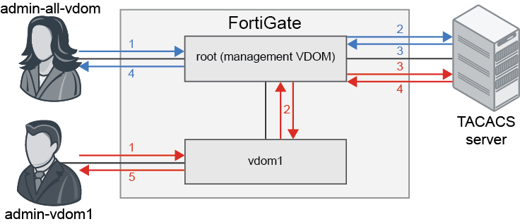

In this example, a FortiGate is configured with multiple VDOMs, and the root acts as the management VDOM. Administrators attempt to log in with SSH or HTTPS through each VDOM.
Using the VSA values for the vdom and admin_prof attributes returned from the TACACS server, the FortiGate can allow access only to the VDOMs returned with the permissions from the corresponding administrator profile. If no VSA values are returned from TACACS, then the FortiGate uses the default values under the config system admin settings.

The authentication process is as follows:
Authentication for admin-all-vdom:
- The administrator attempts to log in to the FortiGate over the remote TACACS user group,
remote-tacacs. - The FortiGate sends an authorization request to the TACACS server.
- TACACS authenticates the admin-all-vdom user. The user matches the
sys_admin_all_vdomTACACS group. TACACS returns following VSA values:memberof = group3admin_prof = admin_all_vdom
- The FortiGate authenticates and authorizes the user based on the returned
memberofgroup. The admin_prof value overwrites theaccprofilesetting configured undersystem admin. Since no other VDOM VSA is returned, the FortiGate matches the user to the default VDOM configured undersystem admin, which isadmin_no_access.
Authentication for admin-vdom1:
remote-tacacs. - vdom1 forwards the request to the management VDOM, which is the root.
- The FortiGate sends an authorization request to the TACACS server through the management VDOM.
- TACACS authenticates the admin-vdom1 user. The user matches the
sys_admin_vdom1TACACS group. TACACS returns following VSA values:memberof = group3admin_prof = admin_vdom1vdom = vdom1
memberofgroup. The other VSA values overwrite theaccprofileand VDOM settings configured undersystem admin. The user is only allowed to access vdom1 with the administrative permissions allowed for admin_vdom1.
