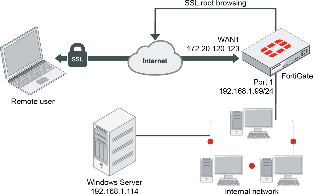

This is a sample configuration of remote users accessing the corporate network through an SSL VPN by web mode using a web browser.
Sample topology
Sample configuration

To configure SSL VPN using the GUI:
  1. Configure the interface and firewall address. The port1 interface connects to the internal network.
    1. Go to Network > Interfaces and edit the wan1 interface.
    2. Set IP/Network Mask to 172.20.120.123/255.255.255.0.
    3. Edit port1 interface and set IP/Network Mask to 192.168.1.99/255.255.255.0.
    4. Click OK.
    5. Go to Policy & Objects > Address and create an address for internet subnet 192.168.1.0.

To see the results:
  1. In a web browser, log into the portal https://172.20.120.123:10443 using the credentials you've set up.
  2. In the portal with the predefined bookmark, select the bookmark to begin an RDP session. If there are no predefined bookmarks, the Quick Connection tool can be used; see Quick Connection tool for more information.
  3. Go to VPN > Monitor > SSL-VPN Monitor to verify the list of SSL users.
  4. Go to Log & Report > Forward Traffic to view the details for the SSL entry.
