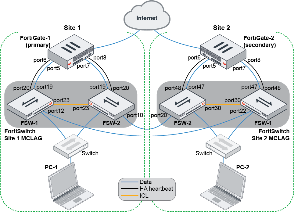

This example shows how to configure heartbeat VLANs to assign to the access ports that the heartbeat interfaces connect to, passing over the trunk between the FortiSwitches on the two sites.
FortiGate HA is with two FortiGates in separate locations and the switch layer connection between the FortiSwitches is used for the heartbeat signal.

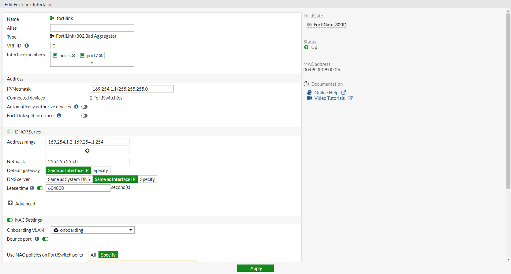

- On the FortiGate, go to WiFi & Switch Controller > FortiLink Interface and configure FortiLink:

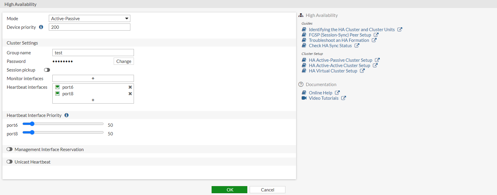

- Go to System > HA and configure HA:
- Set the heartbeat ports to the ports that are connected to FortiSwitch.
- Adjust the priority and enable override so that this FortiGate becomes the primary.

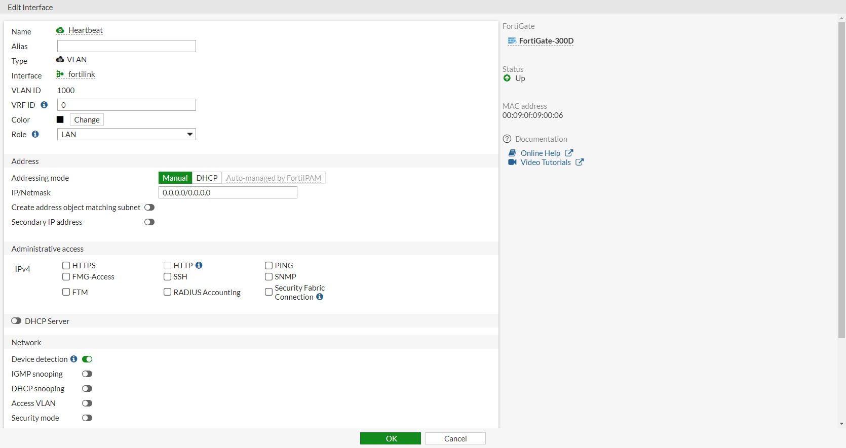

- Go to WiFi & Switch Controller > FortiSwitch VLANs and create a switch VLAN that is dedicated to the FortiGate HA heartbeats between the two FortiGates.

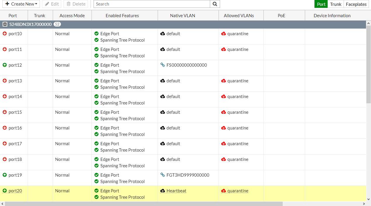

- Assign the native VLAN of the switch ports that are connected to the heartbeat ports to the created VLAN:
- Go to WiFi & Switch Controller > FortiSwitch Ports.
- In the Native VLAN column for the port, click the edit icon and select the Heartbeat VLAN.

- Connect cables between the FortiSwitch MCLAG in Site 1 and Site 2:
- Connect a cable from Site 1 FSW-1 port 12 to Site 2 FSW-1 port 22.
- Connect a cable from Site 1 FSW-2 port 10 to Site 2 FSW-2 port 20.

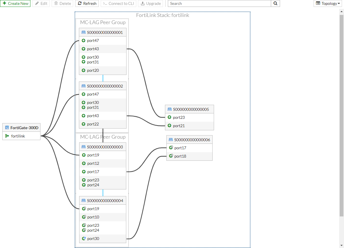

- Wait for HA to finish synchronizing and for all of the FortiSwitches to come online, then on FortiGate-1, go to WiFi & Switch Controller > Managed FortiSwitch.
The page should look similar to the following:

- After an HA failover, on the new primary FortiGate, go to WiFi & Switch Controller > Managed FortiSwitch.
The switch layer tiering will be changed so that the directly connected FortiSwitches are at the top of the topology.
