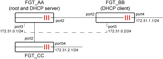

In this example, FGT_AA is the Security Fabric root with IPAM enabled. FGT_BB and FGT_CC are downstream Fabric devices and retrieve IPAM information from FGT_AA. The Fabric interface on all FortiGates is port2. FGT_AA acts as the DHCP server, and FGT_BB acts as the DHCP client.

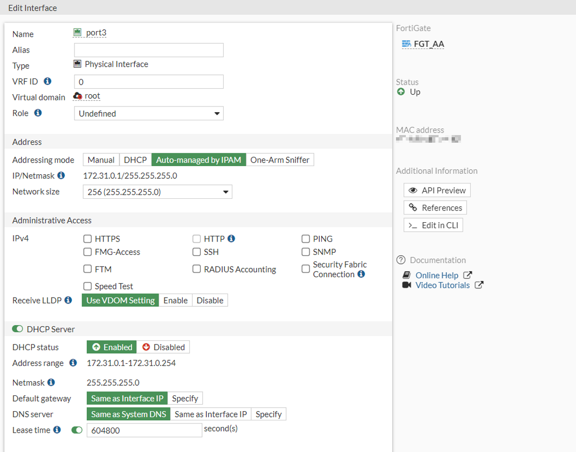

On the root FortiGate, go to Network > Interfaces and edit port3.
For Addressing Mode, select Auto-Managed by IPAM. DHCP Server is automatically enabled.

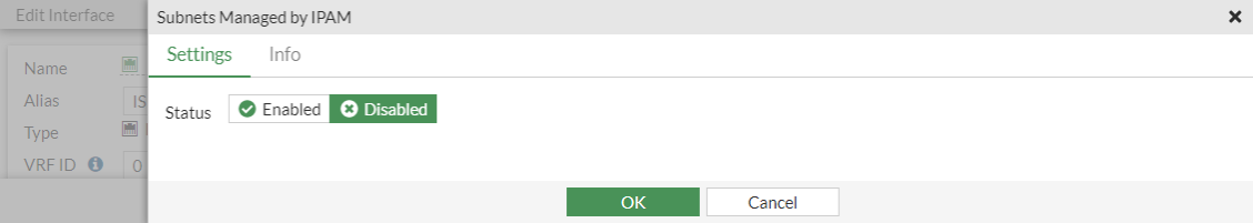

In this example, IPAM is not enabled yet. Click Enable IPAM. The Subnets Managed by IPAM pane opens.

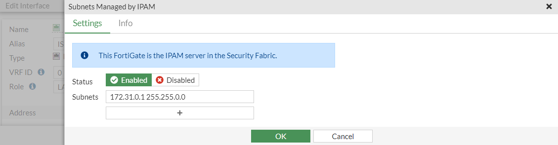

Select Enabled, enter the Pool subnet (only class A and B are allowed) and click OK. The root FortiGate is now the IPAM server in the Security Fabric.

The IP/Netmask field in the Address section has been automatically assigned a class C IP by IPAM. The Address range and Netmask fields in the DHCP Server section have also been automatically configured by IPAM.
Click OK.

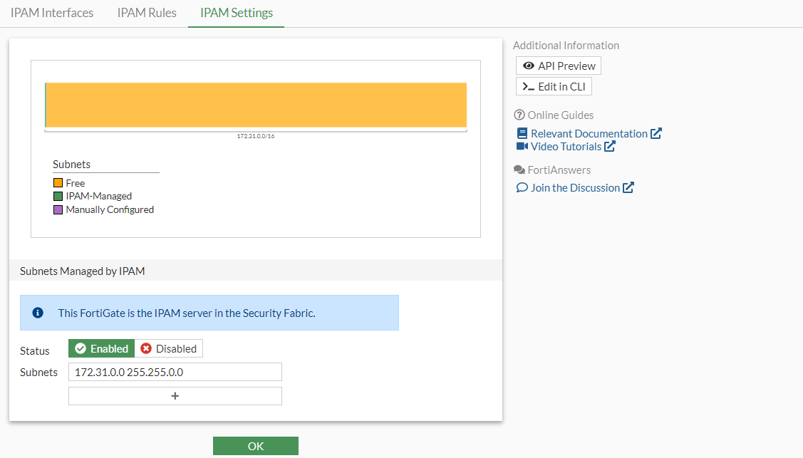

To edit the IPAM subnet:
Go to Network > IPAM > IPAM Settings.
Edit the pool subnet if needed.
Click OK.
On downstream FortiGates, the settings on the Network > IPAM > IPAM Settings tab cannot be changed if IPAM is enabled on the root FortiGate.

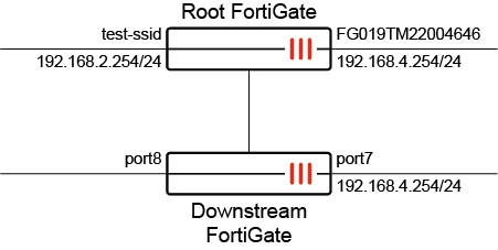

Example 2: wireless network and FortiExtender LAN extension interfaces
In this example, the FortiGate serves as the Security Fabric root and has two interfaces: test-ssid (vap-switch type) and FG019TM22004646 (lan-extension type). Currently, neither interface has an IP address assigned to it.
To configure IPAM on the root FortiGate:

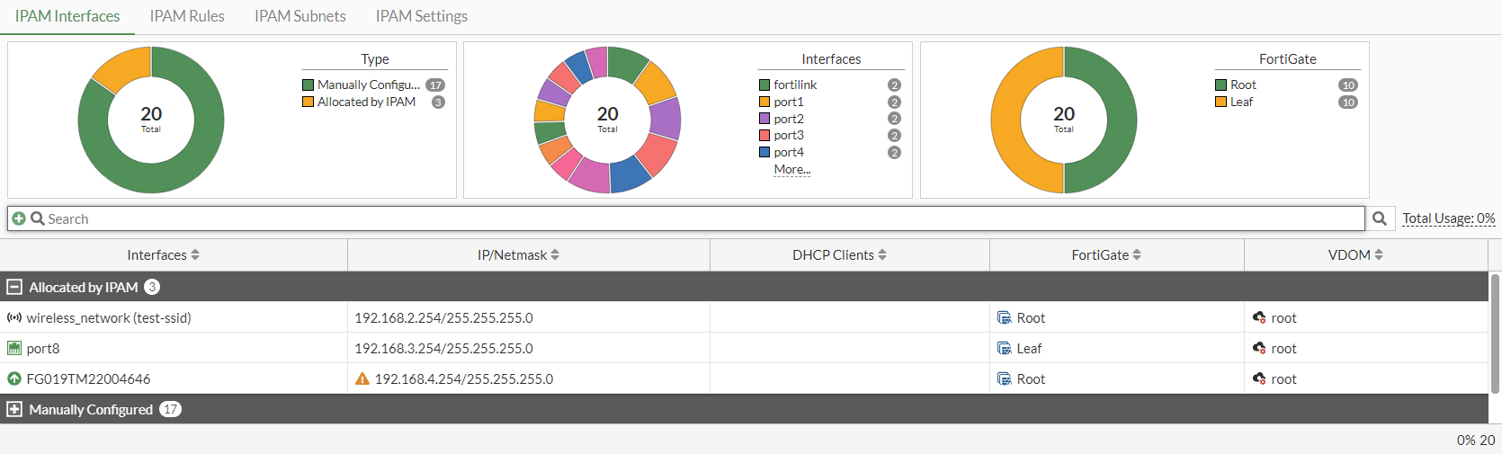

When a downstream FortiGate joins the Security Fabric, the port7 interface is configured with a static IP (192.168.4.254/24), and port8 is set to a LAN role with no IP address assigned. The IPAM server assigns an IP to port8 of the downstream FortiGate since its role was set to LAN. It is observed that the FG019TM22004646 interface of the root FortiGate conflicts with port7 of the downstream FortiGate.
To verify the IP address conflict resolution:
On the root FortiGate, go to Network > IPAM and select the IPAM Interfaces tab.
There is a conflict marker (warning icon) beside the IP address of FG019TM22004646 due to a conflict between the IPAM-assigned interface FG019TM22004646 of the root FortiGate and the manually configured interface of the downstream FortiGate.
Verify the list of IPAM entries in the CLI:
# diagnose sys ipam list entries Entries: (sn, vdom, interface, subnet/mask, conflict) IPAM Entries: FGVM08TM22004645 root test-ssid 192.168.2.254/24 FGVM08TM22004647 root port8 192.168.3.254/24 FGVM08TM22004645 root FG019TM22004646 192.168.4.254/24 C

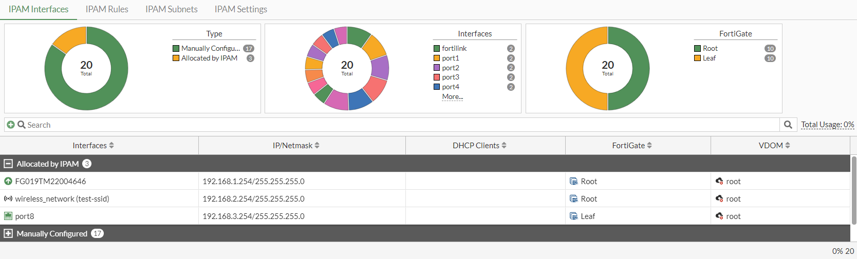

After some time, since Auto-resolve conflicts is enabled in the IPAM settings, the conflict is resolved automatically.
FG019TM22004646 has been assigned a new IP address of 192.168.1.254/24.
If Auto-resolve conflicts is disabled in the IPAM settings, mouse over the conflict marker and select Reallocate IP to manually reallocate the IP address.
# diagnose sys ipam list entries Entries: (sn, vdom, interface, subnet/mask, conflict) IPAM Entries: FGVM08TM22004645 root FG019TM22004646 192.168.1.254/24 FGVM08TM22004645 root test-ssid 192.168.2.254/24 FGVM08TM22004647 root port8 192.168.3.254/24
