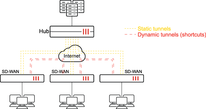

In a hub and spoke SD-WAN topology with shortcuts created over ADVPN, a downed or recovered shortcut can affect which member is selected by an SD-WAN service strategy. When a downed shortcut tunnel recovers and the shortcut is added back into the service strategy, the shortcut is held at a low priority until the hold down time has elapsed.
By default, the hold down time is zero seconds. It can be set to 0 - 10000000 seconds.
The hold down time also applies to the primary VPN tunnels between hub and spoke devices.
