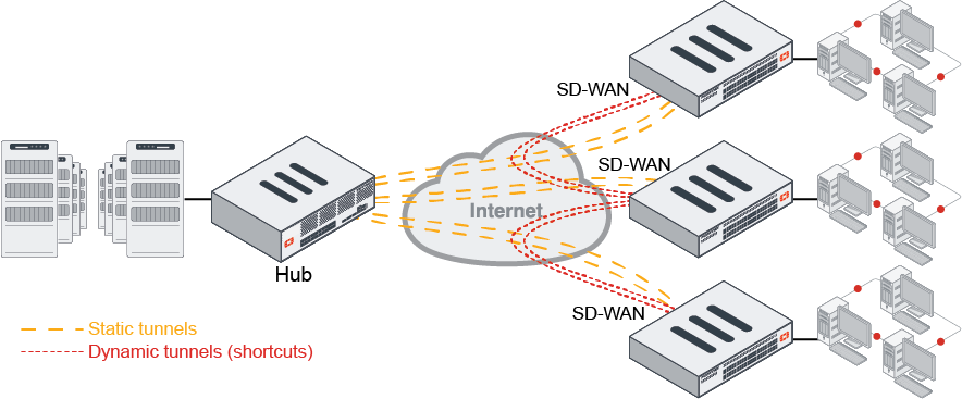

In a hub and spoke SD-WAN topology with shortcuts created over ADVPN, a downed or recovered shortcut can affect which member is selected by an SD-WAN service strategy. When a downed shortcut tunnel recovers and the shortcut is added back into the service strategy, the shortcut is held at a low priority until the hold down time has elapsed.
By default, the hold down time is zero seconds. It can be set to 0 - 10000000 seconds.
The hold down time also applies to the primary VPN tunnels between hub and spoke devices.

In this example, the hold down time is set to 15 seconds, and then the SD-WAN service is looked at before and after the hold down elapses after a downed shortcut recovers.
