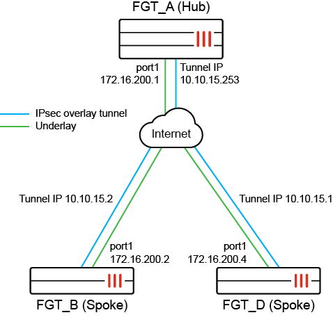

Running speed tests from spokes to the hub in dial-up IPsec tunnels
In this hub and spoke example, the hub is configured as an IPsec VPN dial-up server with two IPsec tunnels, and each tunnel is connected to a spoke. The VPN interfaces and IP addresses are:
FortiGate |
Interface |
IP Address |
FGT_A (Hub) |
hub-phase1 |
10.10.15.253 |
FGT_B (Spoke) |
spoke11-p1 |
10.10.15.2 |
FGT_D (Spoke) |
spoke21-p1 |
10.10.15.1 |
The hub (FGT_A) is configured as a speed-test server to listen on custom ports (6000 and 7000), and the spokes (FGT_B and FGT_D) are configured as speed-test clients. This setup allows speed tests to successfully perform when spokes are behind NAT devices. The results of the speed test will be applied to the hub-phase1 overlay tunnel(s) as specified by the speed-test clients.
