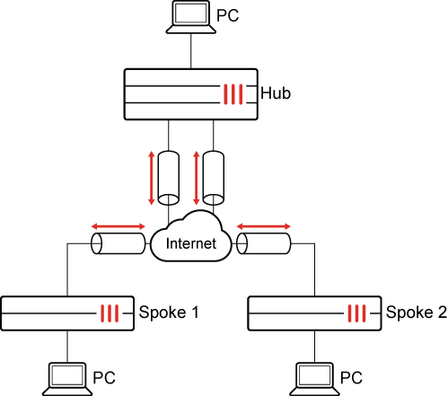

This example shows the configuration of a hub with two spokes.
A peer-egress-shaping-value is configured on both Spoke 1 and Spoke 2, and the peer spoke learns the value through ADVPN's shortcut-reply. Subsequently, each spoke applies the egress bandwidth limit to their overlay tunnel.
The IP addresses are as follows:
FortiGate
Interface
IP adress
Spoke1
Port1
172.16.200.1
Spoke1 PC
Port2
10.1.100.1
Spoke2
Port1
172.16.200.3
Spoke2 PC
Port2
192.168.4.3
Hub
Port1
172.16.200.4
Hub PC
Port2
192.168.5.4
FortiGate
Interface
IP adress
Spoke1
Port1
172.16.200.1
Spoke1 PC
Port2
10.1.100.1
Spoke2
Port1
172.16.200.3
Spoke2 PC
Port2
192.168.4.3
Hub
Port1
172.16.200.4
Hub PC
Port2
192.168.5.4
