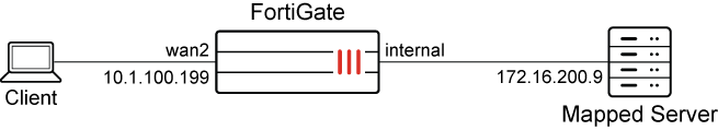

Static Virtual IPs (VIP) are used to map external IP addresses to internal IP addresses. This is also called destination NAT, where a packet's destination is being NAT'd, or mapped, to a different address.
Static VIPs are commonly used to map public IP addresses to resources behind the FortiGate that use private IP addresses. A static one-to-one VIP is when the entire port range is mapped. A port forwarding VIP is when the mapping is configured on a specific port or port range.
When Central NAT is enabled, DNAT is no longer configured on the Policy & Objects > Virtual IPs page and is instead configured on the Policy & Objects > DNAT & Virtual IPs page. See Central DNAT for more information.
Sample configuration
To create a virtual IP in the GUI:
  1. Go to Policy & Objects > Virtual IPs or, if Central NAT is enabled, Policy & Objects > DNAT & Virtual IPs.
  2. Select the Virtual IP or IPv6 Virtual IP tab based on the IP versions used.
  3. Click Create new.
  4. Enter a unique name for the virtual IP.
  5. Enter values for the external IP address/range and map to IPv4/IPv6 address/range fields.
  6. Click OK.

config firewall vip
    edit "Internal_WebServer"
        set extip 10.1.100.199
        set extintf "any"
        set mappedip "172.16.200.55"
To apply a virtual IP to policy in the CLI:
config firewall policy
    edit 8
        set name "Example_Virtual_IP_in_Policy"
        set srcintf "wan2"
        set dstintf "internal"
        set srcaddr "all"
        set dstaddr "Internal_WebServer"
        set service "ALL"
        set nat enable
