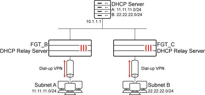

For an IPsec tunnel, the gateway IP address (giaddr) can be defined on a DHCP relay agent. Both IPv4 and IPv6 addresses are supported. An IPsec tunnel with mode‑config and DHCP relay cannot specify a DHCP subnet range to the DHCP server.
The DHCP server assigns an IP address based on the giaddr set on the IPSec phase1 interface and sends an offer to this subnet. The DHCP server must have a route to the specified subnet giaddr.

To define the gateway IP address on the DHCP relay server:

  2. Enable DHCP proxy and configure the DHCP server IP address:
    config system settings
        set dhcp-proxy enable
        set dhcp-server-ip "10.1.1.1"
  3. Repeat the above steps for FGT_C and subnet B.
