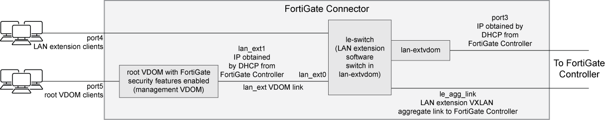

Continuing with the same configuration as Example GUI configuration, a new VDOM named lan-extvdom was created on the FortiGate Connector and its type was set to LAN extension. This configuration allows the VDOM to function as a FortiExtender in LAN extension mode. However, it should be noted that this configuration results in the loss of FortiGate security features on that VDOM. For users who wish to utilize the security features of the FortiGate locally on the FortiGate Connector, another VDOM, such as the root VDOM, can be used.
Once the DHCP server is enabled on the FortiGate Controller (as shown in step 2 of Example GUI configuration), an inter-VDOM link belonging to another VDOM (in this case, the root VDOM) can receive an IP address by DHCP from the FortiGate Controller.
In this topology, the DHCP clients on the FortiGate Connector interact with the different DHCP servers on the FortiGate Controller.
- The port3 IP address is obtained by DHCP from the FortiGate Controller DHCP server on the port3 connected interface.
- The lan_ext1 IP address is obtained by DHCP from the FortiGate Controller DHCP server on the LAN extension interface.

config system interface edit "lan_ext0" set vdom "lan-extvdom" set role lan next edit "lan_ext1" set vdom "root" set mode dhcp next endSince lan_ext0 has its role set to
lan, this interface is added to the le-switch software switch in the lan-extvdom VDOM. This software switch provides network connectivity to the LAN extension clients (in Example GUI configuration) and the root VDOM clients (in this example) through the FortiGate Connector LAN extension VXLAN aggregate link. -
