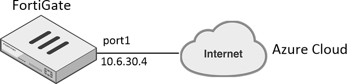

This guide uses an Azure SDN connector as an example. The configuration procedure for all supported SDN connectors is the same. In the following topology, the FortiGate accesses the Azure public cloud through the Internet:

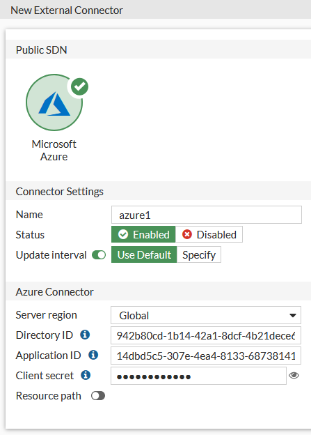

  1. Go to Security Fabric > External Connectors.
  2. Click Create New. Configure the first SDN connector:
    1. Select Microsoft Azure.
    2. In the Name field, enter azure1.
    3. In the Status field, select Enabled.
    4. From the Server region dropdown list, select Global.
    5. In the Directory ID field, enter the directory ID. In this example, it is 942b80cd-1b14-42a1-8dcf-4b21dece61ba.
    6. In the Application ID field, enter the application ID. In this example, it is 14dbd5c5-307e-4ea4-8133-68738141feb1.
    7. In the Client secret field, enter the client secret.
    8. Leave the Resource path disabled.
    9. Click OK.

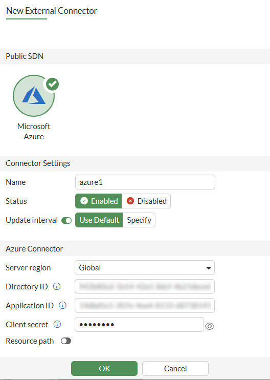

  3. Click Create New. Configure the second SDN connector:
    2. In the Name field, enter azure2.
    6. In the Application ID field, enter the application ID. In this example, it is 3baf0a6c-44ff-4f94-b292-07f7a2c36be6.
    9. Click OK.

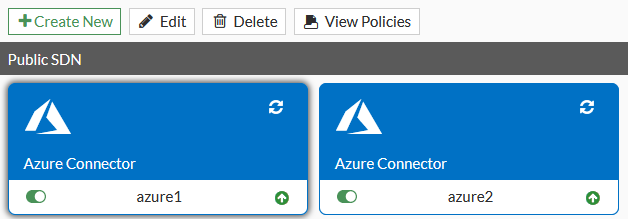

  2. Click the Refresh icon in the upper right corner of each configured SDN connector. A green up arrow appears in the lower right corner, meaning that both SDN connectors are connected to the Azure cloud using different client IDs.

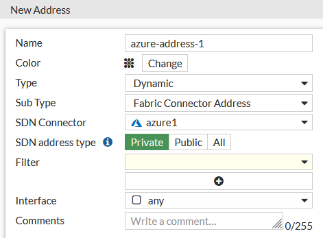

  1. Go to Policy & Objects > Addresses and select Address.
  2. Click Create new. Configure the first SDN connector firewall address:
    1. In the Name field, enter azure-address-1.
    2. From the Type dropdown list, select Dynamic.
    3. From the Sub Type dropdown list, select Fabric Connector address.
    4. From the SDN Connector dropdown list, select azure1.
    5. For SDN address type, select Private.
    6. From the Filter dropdown list, select the desired filter.
    7. For Interface, select any.
    8. Click OK.

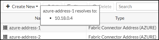

  2. Hover over the created addresses. The firewall address that the configured SDN connectors resolved display.
    9. Click OK.
    9. Click OK.
    8. Click OK.
