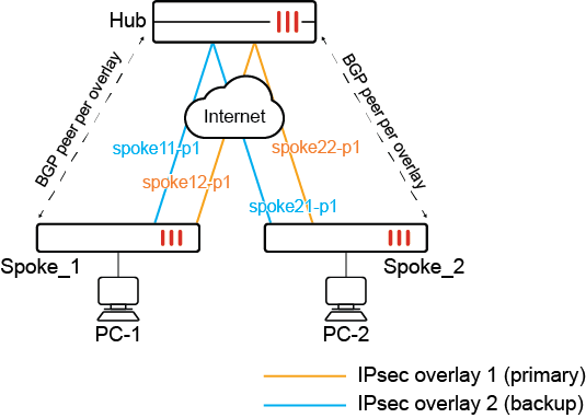

Example topology
The following examples demonstrates using the sla-stickiness option.
After an idle timeout occurs, existing sessions remain on the spoke12-p1_0 backup shortcut tunnel. New sessions will try to create a shortcut over spoke11-p1, but will fall back to spoke12-p1_0 when it detects spoke11-p1 is out of SLA.
Only use case 2 is applicable in ADVPN 2.0 with shortcut stickiness.

Example topology

To configure shortcut stickiness for ADVPN shortcuts:
  1. Configure SD-WAN on the Spoke_1 FortiGate:
    config system sdwan
        set status enable
        config zone
            edit "virtual-wan-link"
                set advpn-select enable
                set advpn-health-check "1"
        config members
                set interface "spoke11-p1"
                set transport-group 1
                set interface "spoke12-p1"
                set transport-group 2
        config health-check
            edit "1"
                set server "9.0.0.1"
                set members 1 2
                config sla
        config service
                set name "1"
                set mode sla
                set dst "all"
                set src "10.1.100.0"
                set sla-stickiness enable
                config sla
                    edit "1"
                        set id 1
                set priority-members 1 2
  2. Verify the SD-WAN configuration.
    1. Verify the health check status:
      # diagnose sys sdwan health-check
      Health Check(1):
      Seq(1 spoke11-p1): state(alive), packet-loss(0.000%), latency(0.186), jitter(0.040), mos(4.404), custom_profile(0.000), bandwidth-up(999999), bandwidth-dw(999996), bandwidth-bi(1999995), sla_map=0x1
      Seq(2 spoke12-p1): state(alive), packet-loss(0.000%), latency(0.131), jitter(0.018), mos(4.404), custom_profile(0.000), bandwidth-up(999999), bandwidth-dw(999996), bandwidth-bi(1999995), sla_map=0x1
    2. Verify the service status:
      # diagnose sys sdwan service4
      Service(1): Address Mode(IPV4) flags=0xc200 use-shortcut-sla use-shortcut sla-stickiness
       Tie break: cfg
       Shortcut priority: 3
        Gen(1), TOS(0x0/0x0), Protocol(0): src(1->65535):dst(1->65535), Mode(sla), sla-compare-order
        Members(2):
          1: Seq_num(1 spoke11-p1 virtual-wan-link), alive, sla(0x1), gid(0), cfg_order(0), local cost(0), selected
          2: Seq_num(2 spoke12-p1 virtual-wan-link), alive, sla(0x1), gid(0), cfg_order(1), local cost(0), selected
        Src address(1):
              10.1.100.0-10.1.100.255
        Dst address(1):
              0.0.0.0-255.255.255.255
      The SD-WAN service rule prefers the primary parent tunnel (spoke11-p1) over the backup parent tunnel (spoke12-p1) before shortcuts are established.
