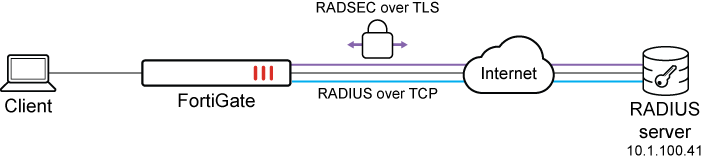

The following topology is used to demonstrate configurations using RADSEC over TLS and RADIUS over TCP.
Example 1: RADSEC over TLS
When using TLS, FortiOS uses port 2083 for RADIUS authentication and RADIUS accounting. There is no need to configure the RADIUS accounting separately.
Before configuring RADSEC over TLS, make sure that the CA certificate (which issues the remote RADIUS server certificate) is imported into the FortiGate trusted root store. If a customized local FortiGate client certificate is used, both the certificate and private key are imported into local FortiGate certificate store.
To configure RADSEC over TLS:

    config user radius
        edit "radius-tcp"
            set server "10.1.100.41"
            set secret ********
            set acct-interim-interval 600
            set transport-protocol tcp
            config accounting-server
                    set status enable
                    set secret ********
  2. Enable fnbamd debug messages on the FortiGate to verify the RADIUS authentication triggered by client traffic requesting access to external networks, which requires user authentication by the firewall policy. Note the highlighted initial RADIUS authentication over TCP: 1812 and initial RADIUS accounting over TCP: 1813:
    # diagnose debug application fnbamd -1
    Debug messages will be on for 30 minutes.
    # diagnose debug enable
    [806] __fnbamd_rad_get_next_addr-Next available address of rad 'radius-tcp': 10.1.100.41:1812.
    [981] __auth_ctx_start-Connection starts radius-tcp:10.1.100.41, addr 10.1.100.41:1812 proto: TCP
    [449] __rad_tcps_open-vfid 0, addr 10.1.100.41, src_ip (null), ssl_opt 0
    [1772] handle_req-r=4
    [418] __rad_tcps_connect-tcps_connect(10.1.100.41) is established.
    [716] __rad_rxtx-fd 10, state 1(Auth)
    [565] fnbamd_rad_make_access_request-
    [329] __create_access_request-Compose RADIUS request
    [549] __create_access_request-Created RADIUS Access-Request. Len: 139.
    [572] __rad_tcps_send-Sent 139/139.
    [574] __rad_tcps_send-Sent all. Total 139.
    [749] __rad_rxtx-Sent radius req to server 'radius-tcp': fd=10, IP=10.1.100.41(10.1.100.41:1812) code=1 id=40 len=139
    [758] __rad_rxtx-Start rad conn timer.
    [806] __fnbamd_rad_get_next_addr-Next available address of rad 'radius-tcp': 10.1.100.41:1813.
    [981] __auth_ctx_start-Connection starts radius-tcp:10.1.100.41, addr 10.1.100.41:1813 proto: TCP
    [1393] create_acct_session-Acct type 6 session created, 0x982b280
    [716] __rad_rxtx-fd 10, state 4(Acct)
    [574] __rad_tcps_send-Sent all. Total 129.
    [749] __rad_rxtx-Sent radius req to server 'radius-tcp': fd=10, IP=10.1.100.41(10.1.100.41:1813) code=4 id=41 len=123
