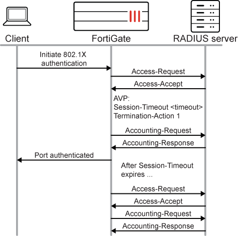

Wired example
This example has a FortiGate configured with a hardware switch with two ports: port3 and port5. The hardware switch is enabled with 802.1X security and assigned to a RADIUS user group. Upon a successful authentication, the RADIUS server responds with an Access-Accept containing the authentication Session-Timeout and Termination-Action attributes. In this example, the Termination-Action value is 1, which informs the client to re-authenticate when the session time expires. During this time, the FortiGate keeps the client/port authorized while it initiates the re-authentication with the RADIUS server.
The message exchange is as follows:
To configure the RADIUS server and the FortiGate to handle the Termination-Action AVP:
  1. On the RADIUS server, configure the Termination-Action AVP with the value RADIUS-Request (1) to indicate that re-authentication should occur upon expiration of the Session-Time.
  2. On the FortiGate, configure the RADIUS server:
    config user radius
        edit "rad1"
            set server "172.18.60.203"
            set secret ENC **********
            set radius-coa enable
            config accounting-server
                    set status enable
  3. Configure the RADIUS user group:
    config user group
        edit "group_radius"
            set member "rad1"
  4. Configure the hardware switch with 802.1X enabled.
    1. Configure the virtual switch settings:
      config system virtual-switch
          edit hw2
              set physical-switch "sw0"
              config port
                  edit port3
                  edit port5
    2. Configure the interface settings:
      config system interface
          edit hw2
              set vdom vdom1
              set ip 6.6.6.1 255.255.255.0
              set allowaccess ping https ssh
              set stp enable
              set security-mode 802.1X
              set security-groups "group_radius"
      WARNING: Changing 802.1X could interrupt network connectivity on affected interfaces.
      Do you want to continue? (y/n)y
  5. On the client device, initiate 802.1X authentication, then verify that the switch port shows as authorized:
    # diagnose sys 802-1x status
    Virtual switch 'hw2' (default mode) 802.1x member status:
      port3: Link up, 802.1X state: unauthorized
      port5: Link up, 802.1X state: authorized
  6. After successful authentication, wait for the session to timeout.
  7. The FortiGate will keep the 802.1X port authenticated, and initiate re-authentication with the same Acct-Session-Id to the RADIUS server. The 802.1X status of the port remains unchanged:

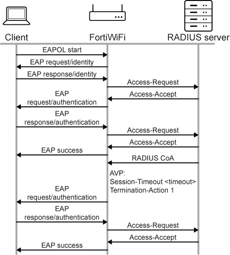

Wireless example
In this example, a virtual AP is configured with WPA2-Enterprise security with RADIUS and has CoA enabled. After a wireless user authenticates and connects to the wireless SSID, the RADIUS server triggers a CoA event with AVPs Session-timeout and a Termination-Action of 1. This signals the FortiGate to trigger re-authentication of the client, which the client immediately performs to stay connected to the wireless SSID.
To configure the FortiGate to handle the Termination-Action AVP:
  1. Configure the RADIUS server:
    config user radius
        edit "peap"
            set server "172.16.200.55"
            set secret **********
  2. Configure the VAP:
    config wireless-controller vap
        edit "wifi"
            set ssid "FWF-60F-coa"
            set security wpa2-only-enterprise
            set auth radius
            set radius-server "peap"
  3. Verify that the wireless station connects to the SSID:
    # diagnose wireless-controller wlac -d sta online
       vf=0 wtp=1 rId=1 wlan=wifi vlan_id=0 ip=10.10.80.2 ip6=:: mac=**:**:**:**:**:** vci= host=wifi-qa-01 user=test1 group=group1 signal=-28 noise=-95 idle=1 bw=0 use=6 chan=149 radio_type=11AC security=wpa2_only_enterprise mpsk= encrypt=aes cp_authed=no online=yes mimo=2
  4. From the RADIUS server, manually trigger a RADIUS CoA event.
    1. RADIUS CoA sent to the FortiGate:
      Sent CoA-Request Id 7 from 0.0.0.0:54158 to 172.16.200.201:3799 length 39
          User-Name = "test1"
          Session-Timeout = 120
          Termination-Action = RADIUS-Request
    2. RADIUS CoA-ACK received from the FortiGate:
      Received CoA-ACK Id 7 from 172.16.200.201:3799 to 0.0.0.0:0 length 44
          Event-Timestamp = "Jan  5 2022 14:43:12 PST"
          Message-Authenticator = 0x3311ba3b763d68da653ab34351b0308
  5. On the wireless station console, verify that the re-authentication happens immediately:
    root@wifi-qa-01:/home/wpa-test# wlan1: CTRL-EVENT-EAP-STARTED EAP authentication started
    wlan1: CTRL-EVENT-EAP-PROPOSED-METHOD vendor=0 method=25
    wlan1: CTRL-EVENT-EAP-METHOD EAP vendor 0 method 25 (PEAP) selected
    EAP-TLV: TLV Result - Success - EAP-TLV/Phase2 Completed
    wlan1: CTRL-EVENT-EAP-SUCCESS EAP authentication completed successfully
    wlan1: PMKSA-CACHE-REMOVED **:**:**:**:**:** 0
    wlan1: PMKSA-CACHE-ADDED **:**:**:**:**:** 0
    wlan1: WPA: Key negotiation completed with **:**:**:**:**:** [PTK=CCMP GTK=CCMP]

Wired example
    config user radius
        edit "rad1"
                    set status enable
    config user group
        edit "group_radius"
            set member "rad1"
          edit hw2
              config port
                  edit port3
                  edit port5
          edit hw2
              set vdom vdom1
              set stp enable
Wireless example
    config user radius
        edit "peap"
        edit "wifi"
            set auth radius
          User-Name = "test1"
