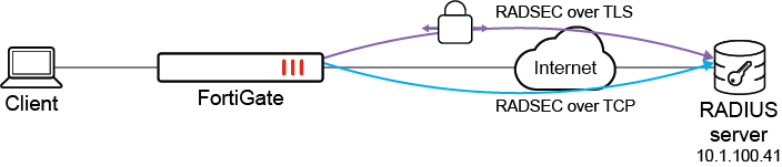

The following topology is used to demonstrate configurations using RADSEC over TLS and RADSEC over TCP.
Example 1: RADSEC over TLS
When using TLS, FortiOS uses port 2083 for RADIUS authentication and RADIUS accounting. There is no need to configure the RADIUS accounting separately.

Example 2: RADSEC over TCP
When using TCP, the default RADIUS ports remain same as with UDP: 1812 for authentication and 1813 for accounting.
