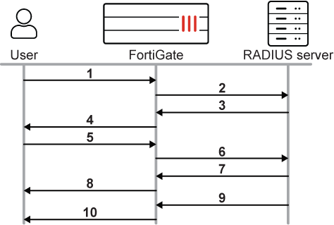

When a user logs in to two devices through RADIUS authentication. The authentication and authorization flow is as follows:
The user logs in to a device and the authentication is sent to the FortiGate.
The FortiGate sends the Access-Request message to the RADIUS server.
The RADIUS server sends the Access-Accept message to the FortiGate. The server also returns the WISPr-Bandwidth-Max-Up and WISPr-Bandwidth-Max-Down VSAs.
Based on the VSA values, the FortiGate applies traffic shaping for the upload and download speeds based on its IP.
The user logs in to a second device and the authentication is sent to the FortiGate.
The RADIUS server sends the Access-Accept message to the FortiGate. The server also returns the WISPr-Bandwidth-Max-Up and WISPr-Bandwidth-Max-Down VSAs at half the value from the first device.
Based on the VSA values, the FortiGate applies traffic shaping for the upload and download speeds on the second device based on its IP.
The RADIUS server sends a CoA message and returns WISPr-Bandwidth-Max-Up and WISPr-Bandwidth-Max-Down VSAs for the first device at half the value.
Based on the VSA values, the FortiGate updates traffic shaping for the upload and download speeds on the first device based on its IP.
