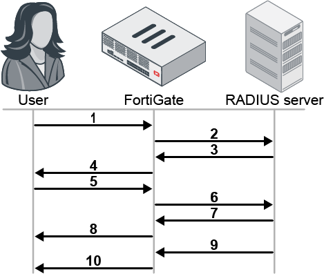

When a user logs in to two devices through RADIUS authentication. The authentication and authorization flow is as follows:
  1. The user logs in to a device and the authentication is sent to the FortiGate.
  2. The FortiGate sends the Access-Request message to the RADIUS server.
  3. The RADIUS server sends the Access-Accept message to the FortiGate. The server also returns the WISPr-Bandwidth-Max-Up and WISPr-Bandwidth-Max-Down VSAs.
  4. Based on the VSA values, the FortiGate applies traffic shaping for the upload and download speeds based on its IP.
  5. The user logs in to a second device and the authentication is sent to the FortiGate.
  6. The FortiGate sends the Access-Request message to the RADIUS server.
  7. The RADIUS server sends the Access-Accept message to the FortiGate. The server also returns the WISPr-Bandwidth-Max-Up and WISPr-Bandwidth-Max-Down VSAs at half the value from the first device.
  8. Based on the VSA values, the FortiGate applies traffic shaping for the upload and download speeds on the second device based on its IP.
  9. The RADIUS server sends a CoA message and returns WISPr-Bandwidth-Max-Up and WISPr-Bandwidth-Max-Down VSAs for the first device at half the value.
  10. Based on the VSA values, the FortiGate updates traffic shaping for the upload and download speeds on the first device based on its IP.

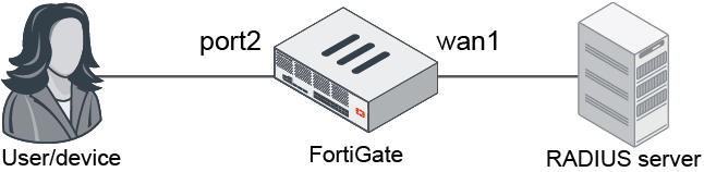

Example
In this example, the FortiGate is configured to dynamically shape user traffic based on the WISPr-Bandwidth-Max-Up and WISPr-Bandwidth-Max-Down VSAs returned by the RADIUS server when the user logs in through firewall authentication.
To configure traffic shaping based on dynamic RADIUS VSAs:
  1. Configure the RADIUS server users file to identify WISPr-Bandwidth-Max-Up and WISPr-Bandwidth-Max-Down:
    The WISPr-Bandwidth is measured in bps, and the FortiOS dynamic shaper is measured in Bps.
    WISPr-Bandwidth-Max-Up = 1004857,
    WISPr-Bandwidth-Max-Down = 504857,
  2. In FortiOS, configure the RADIUS server:
    config user radius
        edit "rad1"
            set server "172.16.200.44"
            set secret ************
            set radius-coa enable
            set acct-all-servers enable
            config accounting-server
                    set status enable
  3. Configure the RADIUS user group:
    config user group
        edit "group_radius"
            set member "rad1"
  4. Configure the firewall policy with dynamic shaping and the RADIUS group:
    config firewall policy
            set srcintf "port2"
            set dstintf "wan1"
            set srcaddr "all"
            set dstaddr "all"
            set srcaddr6 "all6"
            set dstaddr6 "all6"
            set service "ALL"
            set dynamic-shaping enable
            set groups "group_radius"
            set nat enable
Verification
