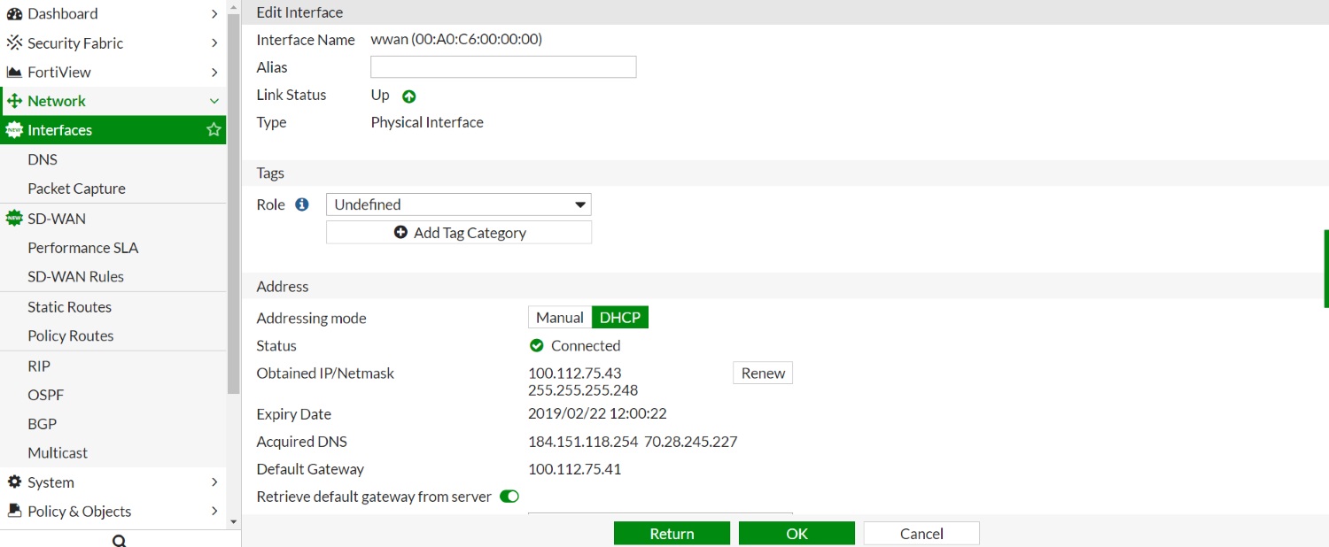

When an LTE modem is enabled, you can view the LTE interface in the GUI and check the acquired IP, DNS, and gateway.
To view the LTE interface in the GUI:
- Go to Network > Interfaces.
- Double-click the LTE interface to view the properties.
- Look in the Address section to view the:
- Obtained IP
- Acquired DNS
- Default Gateway
- Click Return.

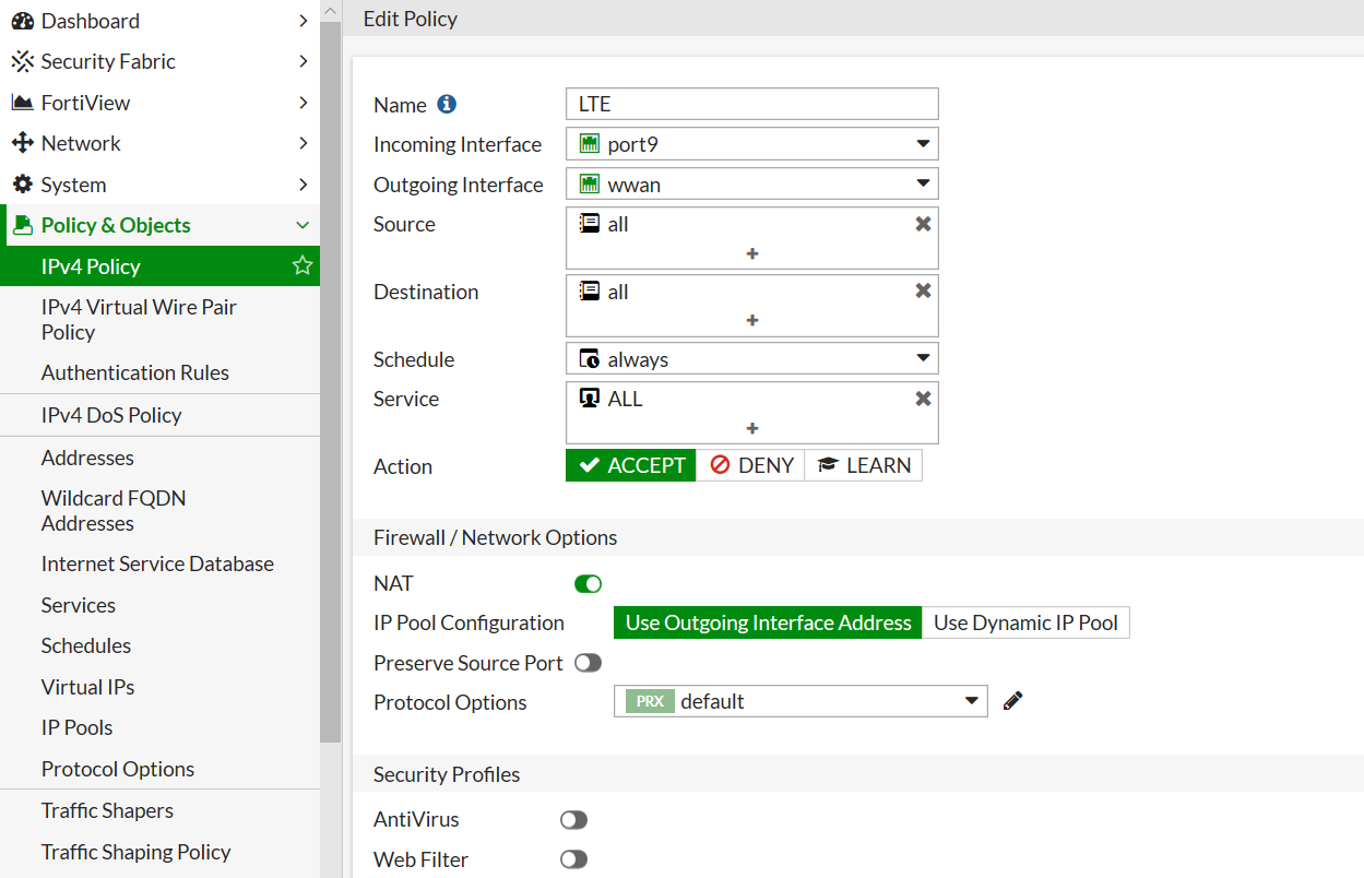

To configure the firewall policy that uses the LTE interface:
- Go to Policy & Objects > IPv4 Policy.
- Double-click the LTE policy. The Edit Policy pane opens.
- In the Outgoing Interface field, select the interface (
wwanin this example). - Configure the rest of the policy as needed.
- Click OK.
