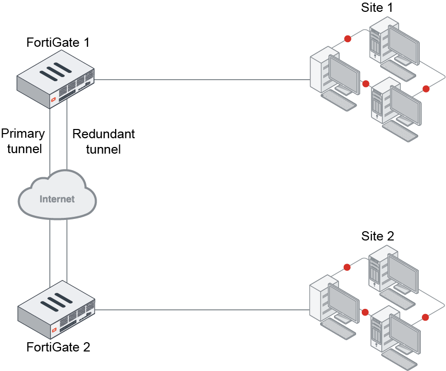

A FortiGate with two interfaces connected to the internet can be configured to support redundant VPNs to the same remote peer. Four distinct paths are possible for VPN traffic from end to end. If the primary connection fails, the FortiGate can establish a VPN using the other connection.
Topology
The redundant configuration in this example uses route-based VPNs. The FortiGates must operate in NAT mode and use auto-keying.
This example assumes the redundant VPNs are essentially equal in cost and capability. When the original VPN returns to service, traffic continues to use the replacement VPN until the replacement VPN fails. If the redundant VPN uses more expensive facilities, only use it as a backup while the main VPN is down.
