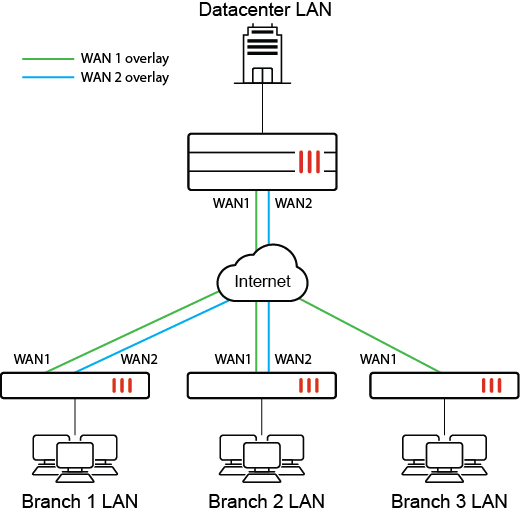

Topology
This topology is used in the following procedures:

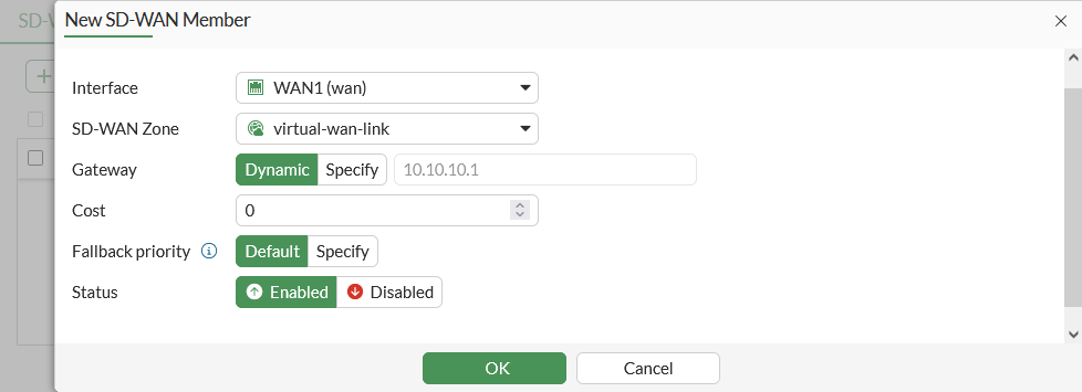

Configuring SD-WAN member interfaces
When configuring SD-WAN zones and members, it does not matter what order they are defined. In this example, the members are defined first, and they will be placed temporarily in the default zone called virtual-wan-link. A zone must be defined when creating a member, and the overlay and underlay zones will created in the next procedure. It is standard practice to create SD-WAN members for each underlay and overlay interface, as most SD-WAN implementations apply SD-WAN intelligence to both underlay and overlay networks.
The following options can be configured for SD-WAN members:
GUI option
CLI option
Interface
interface
Select the interface to use as an SD-WAN member. Optionally, select None in the GUI to not use an interface yet.
SD-WAN Zone
zone
Select the destination zone if it exists at the time of member creation. Otherwise, the default virtual-wan-link zone is applied.
A new zone can be created within the GUI dropdown field.
Gateway/IPv6 Gateway
gateway/gateway6
Enter the default gateway for the interface. For interfaces that already have a default gateway, such as those configured using DHCP, this field is pre-populated in the GUI.
Cost
cost
Enter the cost of the interface for services in SLA mode (0 - 4294967295, default = 0). A lower cost has a higher preference.
Fallback priority
priority
Enter the priority of the interface for IPv4 (1 - 65535, default = 1). The priority is used in the static route created for the SD-WAN member interface and in SD-WAN rules (including the implicit rule). When priority is used to determine the best route, the lower value takes precedence.
Status
status
Enable or disable the interface in SD-WAN.
n/a
source/source6
Set the source IP address used in the health check packet to the server.
To configure the SD-WAN members and add them to the default zone in the GUI:
  1. Go to Network > SD-WAN, select the SD-WAN Zones tab, and click Create New > SD-WAN Member.
  2. Set the Interface to WAN1.
  3. Leave the SD-WAN Zone as virtual-wan-link.
  4. Click OK.
  5. Repeat these steps to create SD-WAN members for the WAN2, VPN1, and VPN2 interfaces.

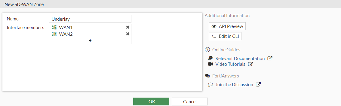

Configuring SD-WAN zones
While SD-WAN zones are primarily used to logically group interfaces that are often used for the same purpose (such as WAN1 and WAN2), sometimes an SD-WAN zone can have a single member. This is due to the constraint that SD-WAN members may not be referenced directly in policies; however, SD-WAN members can be referenced directly in SD-WAN rules.
In this example, two zones named Overlay and Underlay are configured, and the member interfaces are added to their respective zones.
To configure the SD-WAN zones in the GUI:
  1. Go to Network > SD-WAN and select the SD-WAN Zones tab.
  2. Click Create New > SD-WAN Zone.
  3. Enter the Name, Underlay.
  4. Set the Interface members to WAN1 and WAN2.
  5. Click OK.
  6. Repeat these steps to configure the Overlay zone with members VPN1 and VPN2.
