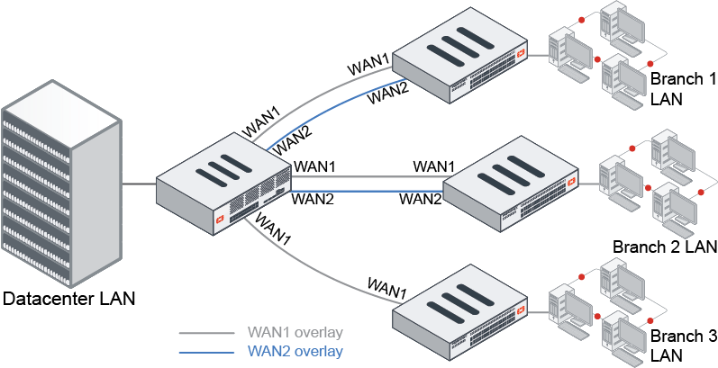

Topology
This topology is used in the following procedures:

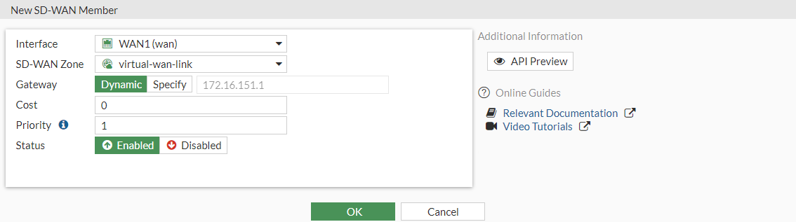

To configure the SD-WAN members and add them to the default zone in the GUI:
Go to Network > SD-WAN, select the SD-WAN Zones tab, and click Create New > SD-WAN Member.
Set the Interface to WAN1.
Leave the SD-WAN Zone as virtual-wan-link.
Click OK.
Repeat these steps to create SD-WAN members for the WAN2, VPN1, and VPN2 interfaces.

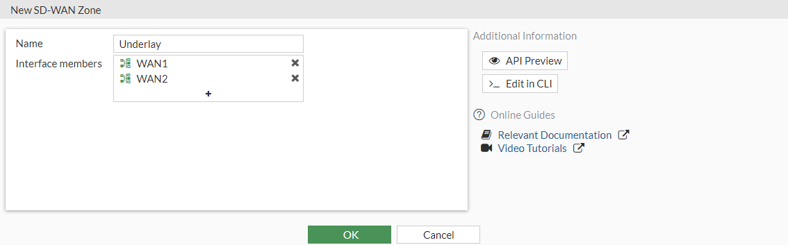

To configure the SD-WAN zones in the GUI:
Go to Network > SD-WAN and select the SD-WAN Zones tab.
Click Create New > SD-WAN Zone.
Enter the Name, Underlay.
Set the Interface members to WAN1 and WAN2.
Click OK.
Repeat these steps to configure the Overlay zone with members VPN1 and VPN2.
