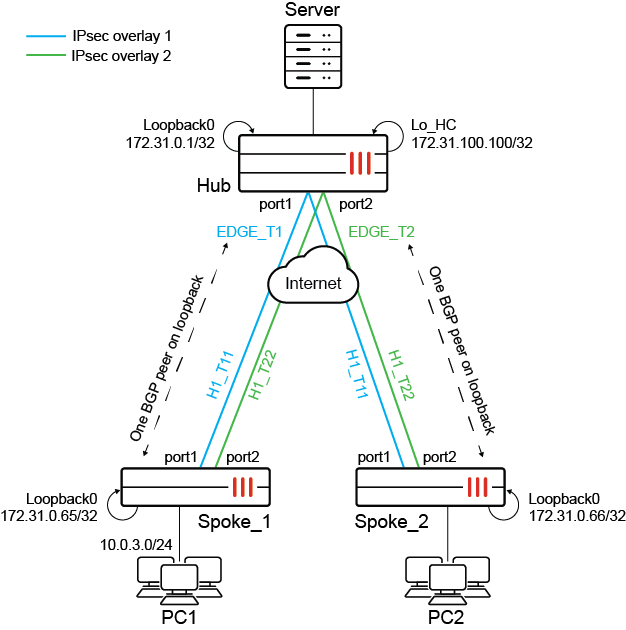

In the hub and spoke SD-WAN design, in order for traffic to pass symmetrically from spoke to hub and hub to spoke, it is essential for the hub to know which IPsec overlay is in SLA and out of SLA. Prior to introducing embedded SLA information in ICMP probes, it is common practice for spokes to use the SD-WAN neighbor feature and route-map-out-preferable setting to signal the health of each overlay to the hub. However, this requires BGP to be configured per overlay, and to manipulate BGP routes using custom BGP communities.
With embedded SLA information in ICMP probes, spokes can communicate their SLA for each overlay directly through ICMP probes to the hub. The hub learns these SLAs and maps the status for each spoke and its corresponding overlays.
The hub uses the SLA status to apply priorities to the IKE routes, giving routes over IPsec overlays that are within SLAs a lower priority value and routes over overlays out of SLAs a higher priority value. If BGP is used, recursively resolved BGP routes can inherit the priority from its parent.
Embedded SLA information in ICMP probes allows hub and spoke SD-WAN to be designed with a BGP on loopback topology, or without BGP at all. The following topology outlines an example of the BGP on loopback design where each spoke is peered with the hub and route reflector on the loopback interface.
In this topology, each FortiGate’s BGP router ID is based on its Loopback0 interface. Each spoke has SLA health checks defined to send ICMP probes to the server’s Lo_HC interface on 172.31.100.100. The ICMP probes include embedded SLA information for each SD-WAN overlay member.

Example with BGP on loopback SD-WAN
This example demonstrates the configurations needed to configure the SD-WAN and BGP settings for the preceding topology. It is assumed that IPsec VPN overlays are already configured per the topology, and that loopback interfaces are already configured on each FortiGate.
Configuring the Spoke_1 FortiGate
In the SD-WAN settings, note the following requirements:
  1. Configure the SD-WAN zones and members. For each SD-WAN member, define the source of its probes to be the Loopback0 interface IP.
  2. Configure the SLA health check to point to the Hub’s Lo_HC interface and IP. Enable embed-measured-health.
