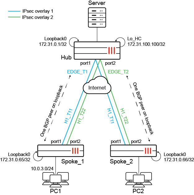

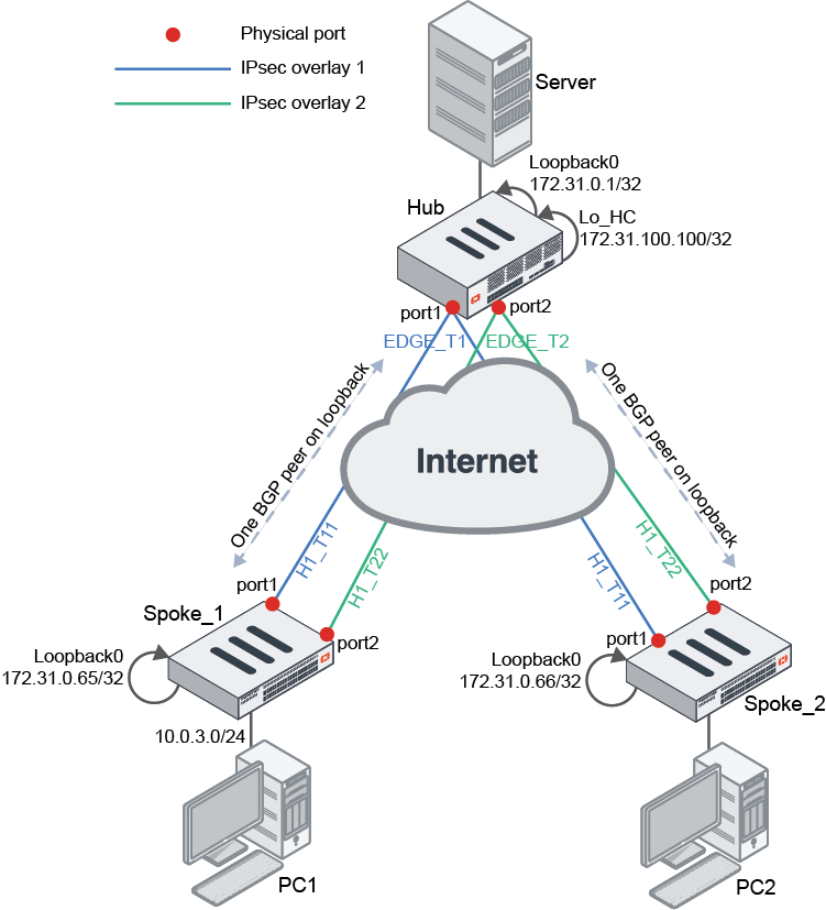

Embedded SLA information in ICMP probes allows hub and spoke SD-WAN to be designed with a BGP on loopback topology, or without BGP at all. The following topology outlines an example of the BGP on loopback design where each spoke is peered with the hub and route reflector on the loopback interface.
In this topology, each FortiGate’s BGP router ID is based on its Loopback0 interface. Each spoke has SLA health checks defined to send ICMP probes to the server’s Lo_HC interface on 172.31.100.100. The ICMP probes include embedded SLA information for each SD-WAN overlay member.

Example with BGP on loopback SD-WAN
This example demonstrates the configurations needed to configure the SD-WAN and BGP settings for the preceding topology. It is assumed that IPsec VPN overlays are already configured per the topology, and that loopback interfaces are already configured on each FortiGate.
