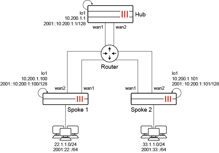

In a topology where the Spoke 1 and Spoke 2 FortiGates are connected directly to the Hub FortiGate, route reflection will not be enabled. The Hub FortiGate is only configured with each spoke's summary route. An ADVPN shortcut tunnel is established between the Spoke 1 and Spoke 2 FortiGates. The valid routing between the Spoke 1 and Spoke 2 FortiGate is still through the Hub FortiGate at this point.
When a host behind Spoke 1 tries to connect to a host behind Spoke 2, Spoke 1 first reaches the Hub based on the valid routing table. The Hub determines that the destination is reachable, and the ADVPN shortcut tunnel between the spokes is established. Then, Spoke 1 and Spoke 2 will actively initiate a BGP connection to each other over the shortcut. Once established, they will exchange their routing information using BGP. On both spokes, BGP will resolve those routes on the shortcut and update the routing table accordingly.

Example
This example configuration contains the following structure:
  • Use SD-WAN member 1 (via ISP1) and its dynamic shortcuts for Financial Department traffic.
  • Use SD-WAN member 2 (via ISP2) and its dynamic shortcuts for Engineering Department traffic.
  • Internal subnets of Spoke 1:
    • IPv4: 22.1.1.0/24
    • IPv6: 2001:22::/64
  • Internal subnets of Spoke 2:
    • IPv4: 33.1.1.0/24
      • Financial Department: 33.1.1.1 to 33.1.1.100
      • Engineering Department: 33.1.1.101 to 33.1.1.200
    • IPv6: 2001:33::/64
      • Financial Department: 2001:33::1 to 2001:33::100
      • Engineering Department: 2001:33::101 to 2001:33::200
    • IPv4: 22.1.1.0/24
    • IPv4: 33.1.1.0/24

Because route reflection has been disabled in this example, initially, Spoke 1 will not know the local subnet of Spoke 2, and Spoke 2 will not know the local subnet of Spoke 1. Therefore, for traffic routing, summary routes are configured on the hub as blackhole routes and then advertised to the spokes using BGP.
For example, for traffic from the local subnet of Spoke 2 destined for the local subnet of Spoke 1:
  • For the IPv4 case, the summary route 22.0.0.0/8, which includes the local subnet of Spoke 1 (22.1.1.0/24), is advertised to Spoke 2. When Spoke 2 sends traffic destined for 22.1.1.0/24 to the Hub, the Hub forwards this traffic to Spoke 1 since they are BGP neighbors.
  • For the IPv6 case, the summary route 2001:22::/32, which includes the local subnet of Spoke 1 (2001:22::/64), is advertised to Spoke 2. When Spoke 2 sends traffic destined for 2001:22::/64 to the Hub, the Hub forwards this traffic to Spoke 1 since they are BGP neighbors.
Although traffic from spoke-to-spoke goes through the hub first, it is expected that the spoke will eventually go through the shortcut tunnel.

    B       2001:33::/32 [200/0] via 2001::10:200:1:1 (recursive via spoke1-1 tunnel ::11.1.1.11), 00:17:30
                                                      (recursive via spoke1-2 tunnel ::111.1.1.11), 00:17:30, [1024/0]
    B       2001:33::/64 [200/0] via 2001::10:200:1:101 (recursive via spoke1-1_0 tunnel ::13.1.1.3), 00:00:24, [1024/0]
    The remote route learned from Spoke 2 through the spoke1-1_0 tunnel and using BGP is 2001:33::/64.
Verifying the configuration after a second spoke-to-spoke shortcut VPN is established
IPv4 use case
To trigger a second spoke-to-spoke shortcut VPN, on host 22.1.1.22, ping the host 33.1.1.133 in the Engineering Department. Because of the SD-WAN rule, use SD-WAN member 2 (via ISP2) and its dynamic shortcuts to reach hosts in the Engineering Department.
To verify the status on Spoke 1:
  1. Verify the BGP status:
    # get router info bgp summary
    VRF 0 BGP router identifier 10.200.1.100, local AS number 65100
    BGP table version is 6
    1 BGP AS-PATH entries
    0 BGP community entries
    Neighbor     V         AS MsgRcvd MsgSent   TblVer  InQ OutQ Up/Down  State/PfxRcd
    10.200.1.1   4      65100     263     265        3    0    0 00:18:12        3
    10.200.1.101 4      65100      17      17        5    0    0 00:01:04        1
    Total number of neighbors
    Spoke 1 continues to have its BGP neighbors:
    • Hub FortiGate at 10.200.1.1
    • Spoke 2 FortiGate at 10.200.1.101
  2. Verify the BGP routing table:
    # get router info routing-table bgp
    Routing table for VRF=0
    B       11.11.11.11/32 [200/0] via 10.200.1.1 (recursive via spoke1-1 tunnel 11.1.1.11), 00:18:17
                                                  (recursive via spoke1-2 tunnel 111.1.1.11), 00:18:17, [1/0]
    B       22.0.0.0/8 [200/0] via 10.200.1.1 (recursive via spoke1-1 tunnel 11.1.1.11), 00:18:17
    B       33.0.0.0/8 [200/0] via 10.200.1.1 (recursive via spoke1-1 tunnel 11.1.1.11), 00:18:17
    B       33.1.1.0/24 [200/0] via 10.200.1.101 (recursive via spoke1-1_0 tunnel 13.1.1.3), 00:01:09
                                                 (recursive via spoke1-2_0 tunnel 113.1.1.3), 00:01:09, [1/0]
    The remote route learned from Spoke 2 through the spoke1-2_0 tunnel and using BGP is 33.1.1.0/24.
IPv6 use case
To trigger a second spoke-to-spoke shortcut VPN over IPv6, on host 2001:22::22/64, ping the host 2001:33::133/64 in the Engineering Department. Because of the SD-WAN rule, use SD-WAN member 2 (via ISP2) and its dynamic shortcuts to reach hosts in the Engineering Department.
    # get router info6 bgp summary
    BGP table version is 7
    2001::10:200:1:1   4      65100     264     265        4    0    0 00:18:18        3
    2001::10:200:1:101 4      65100      19      19        6    0    0 00:01:11        1
    Total number of neighbors 2
    • Hub FortiGate at 2001::10:200:1:1
    • Spoke 2 FortiGate at 2001::10:200:1:101
    # get router info6 routing-table bgp
    B       2001::11:11:11:11/128 [200/0] via 2001::10:200:1:1 (recursive via spoke1-1 tunnel ::11.1.1.11), 00:18:20
                                                               (recursive via spoke1-2 tunnel ::111.1.1.11), 00:18:20, [1024/0]
    B       2001:22::/32 [200/0] via 2001::10:200:1:1 (recursive via spoke1-1 tunnel ::11.1.1.11), 00:18:20
    B       2001:33::/32 [200/0] via 2001::10:200:1:1 (recursive via spoke1-1 tunnel ::11.1.1.11), 00:18:20
    B       2001:33::/64 [200/0] via 2001::10:200:1:101 (recursive via spoke1-1_0 tunnel ::13.1.1.3), 00:01:14
                                                        (recursive via spoke1-2_0 tunnel ::113.1.1.3), 00:01:14, [1024/0]
    The remote route learned from Spoke 2 through the spoke1-2_0 tunnel and using BGP is 2001:33::/64.
